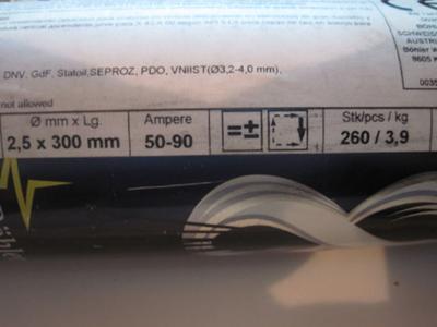

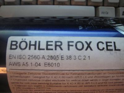

After using it with rutile and basic rods (say 6013 and 7018) I wanted to try celullosic rods (6010 or 6011). I had a true hard time finding them here in Spain since no known LWS had them or was even willing to get some for me. I managed to get a hold on "some" Bohler Fox CELL 6010 2,5mm electrodes. When I say some, read 12kg in three separate airtight cans of 4kg each).

PD: Find attached a few pictures of the rods I am trying to burn.
