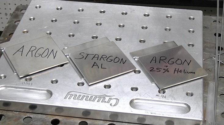

I set up 3 lap joints using .125" thick 6061 aluminum.
I set the amperage at 130 and welded full pedal on all three lap joints using a CK worldwide MT200 AC/DC tig welder.

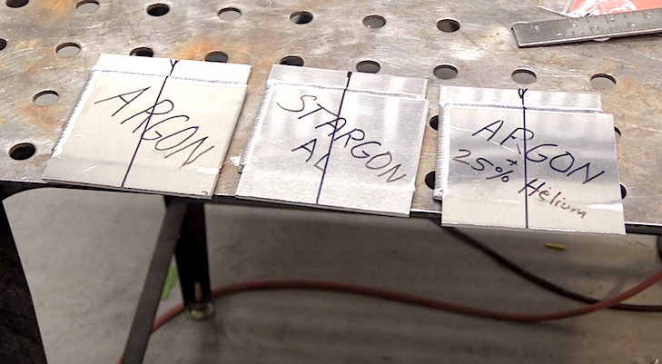

I decided to use a clear #5 cup for all filming of the arcs because a #5 usually is a good choice for tig welding .125" aluminum and clear cups help with us all to see the arc and puddle better.
But the Stargon AL didnt seem to like the #5 cup as well as the pure argon and the Ar/He mix.
Travel speed on the Stargon AL lap joint was super slow and the puddle was sluggish.
That really surprised me because my earlier experience with Stargon AL was that travel speed actually increased.

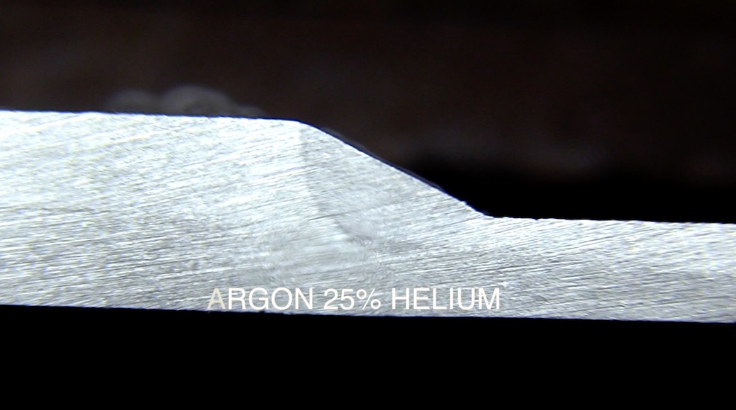

Cut and etch for penetration...(because 1 test is worth 100 opinions)
I like to use the cut and tech macro test to verify penetration.
A macro test is pretty quick and easy to do and it gives quick results.
I polished these samples using a belt sander starting with 120 grit and gradually using finer grit until I got to 600 grit.
Then I used Easy Off oven cleaner and a Q tip to swab etch to reveal weld nugget

argon helium mix #5 cup
