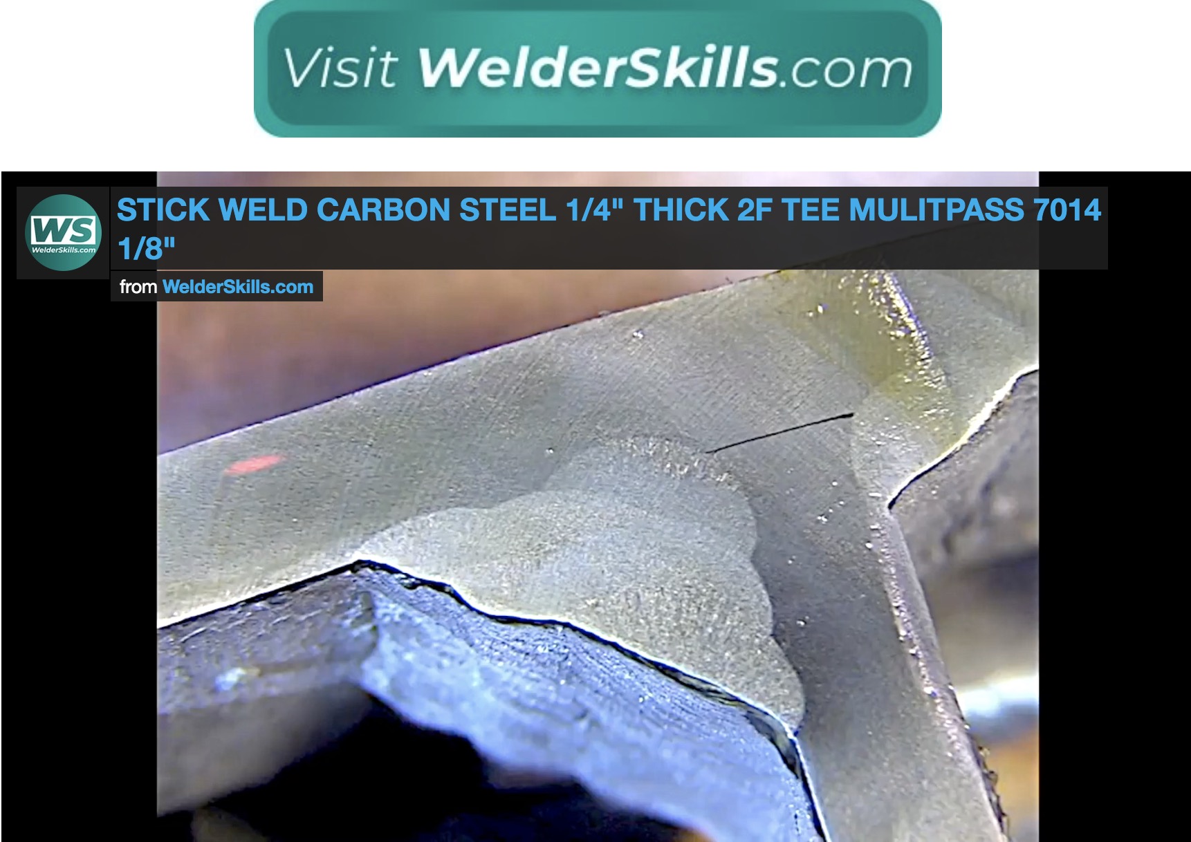

STICK WELD CARBON STEEL 1/4" THICK 2F TEE MULITPASS 7014 1/8"
WELD PROCESS = SMAW, SHIELDED METAL ARC WELDING, STICK WELDING
METAL TYPE = CARBON STEEL,  A36 STEEL
THICKNESS = 1/4"
WELD TYPE = Fillet weld MULTI PASS
JOINT TYPE = TEE
POSITION = 2F
AMPS = 125 AMPS
POLARITY = DCEP
ELECTRODE = 7014 1/8"
ADDITIONAL SETTINGS =
TIPS:SET THE AMPERAGE HOT ENOUGH TO NOT STICK THE ROD WHEN YOU HOLD A TIGHT ARC…THEN HOLD A TIGHT ARC.
DIFFERENT MANUFACTURERS ELECTRODES REQUIRE SLIGHTLY DIFFERENT AMPERAGE SETTINGS.this  AMPERAGE SHOULD GET YOU IN THE BALL PARK.TWEAK AMPS FROM THAT POINT AND ADJUST ARC CONTROL TO FIT THE SITUATION
