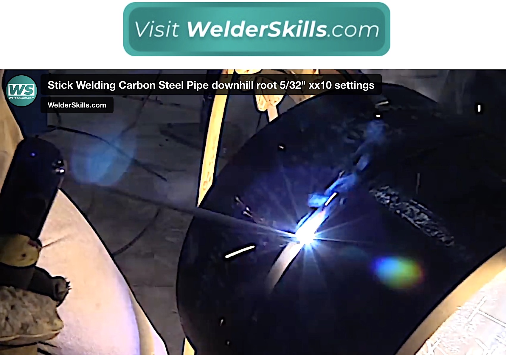

Stick Welding Carbon Steel Pipe downhill root 5/32" xx10 settings
scroll down for settings
WELD PROCESS = SMAW, SHIELDED METAL ARC WELDING, STICK WELDING
METAL TYPE = CARBON STEEL
THICKNESS = 3/8” WALL 12 INCH PIPE
WELD TYPE = 12 INCH PIPE DOWNHILL ROOT PASS 3/32" GAP, 3/32" LAND
JOINT TYPE = BUTT
POSITION = 5G DOWNHILL
AMPS = 126-132 AMPS
POLARITY = DCEP
ELECTRODE = 7010 5/32"
ADDITIONAL SETTINGS =
TIPS: DIFFERENT MANUFACTURERS ELECTRODES REQUIRE SLIGHTLY DIFFERENT AMPERAGE SETTINGS.ANY SUCCESSFUL DEMONSTRATION DISPLAYING AMPERAGE SHOULD GET YOU IN THE BALL PARK.TWEAK AMPS FROM THAT POINT AND ADJUST ARC CONTROL TO FIT THE SITUATION
