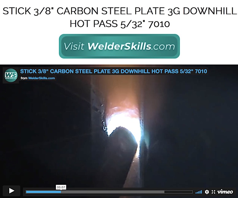

STICK 3/8" CARBON STEEL PLATE 3G DOWNHILL HOT PASS 5/32" 7010
WELD PROCESS = SMAW, SHIELDED METAL ARC WELDING, STICK WELDING
METAL TYPE = CARBON STEEL
THICKNESS = 3/8"
WELD TYPE = GROOVE WELD  HOT PASS
JOINT TYPE = BUTT
POSITION = 3G DOWNHILL PLATE
AMPS = 135 AMPS
POLARITY = DCEP
ELECTRODE = 7010  5/32"
ADDITIONAL SETTINGS =
DIFFERENT MANUFACTURERS ELECTRODES REQUIRE SLIGHTLY DIFFERENT AMPERAGE SETTINGS.
ANY SUCCESSFUL DEMONSTRATION DISPLAYING AMPERAGE SHOULD GET YOU IN THE BALL PARK.
TWEAK AMPS FROM THAT POINT AND ADJUST ARC CONTROL TO FIT THE SITUATION
