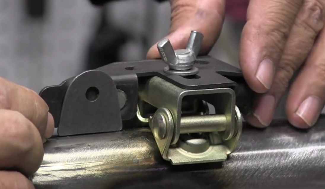

Stronghand tools MagTab
Ever heard of a MagTab?
check out the magtab at the Weldmonger Store
Stronghand makes a little simple tool called a MagTab.
Its for hold small tabs and other stuff in place accurately while you get a tack weld on it.
I have used the crap out of mine for about 4 years now.
I usually make a small tack weld and then remove the magtab so as not to damage the magnets.
Of course, like most welders, I have used my fingers to hold stuff while I tack welded.  I have the scars to prove it.
I have used the magtab for all kinds of things other than than tack welding tabs....like putting together outside corner joints on a steel tray.
Its one of the handier items in my toolbox.
