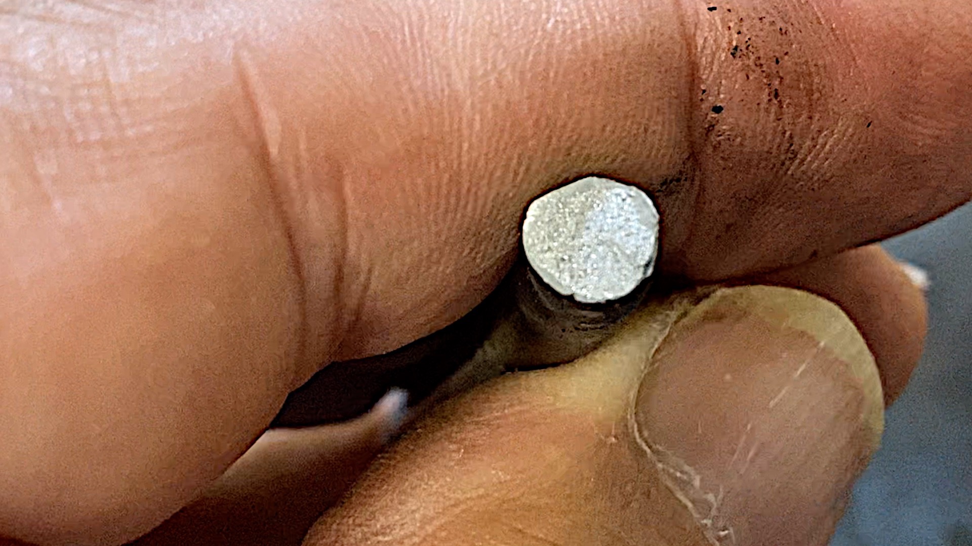

I did a favor for someone recently and I welded a high carbon steel spring loaded pin like the kind you see on gym equipment.
The pin had sheared and showed a fractured surface that looked like this.
high-carbon-brittle-facture
A brittle fracture with no bending .  partly due to no radius in the corner.

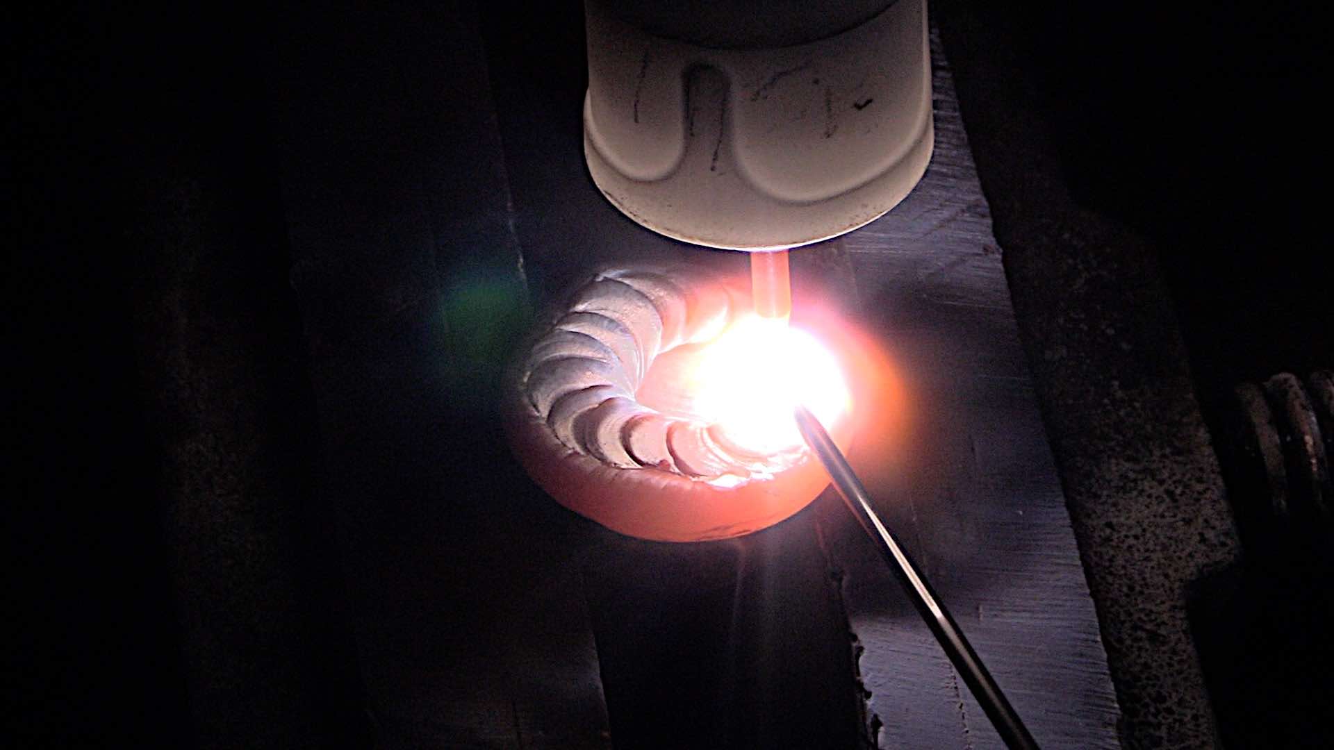

Next, I ran a very small bead of 312 stainless around the edge of the ledge to preheat the part.  I used a furick jazzy 10 cup for this to keep all the red hot area shielded with argon.

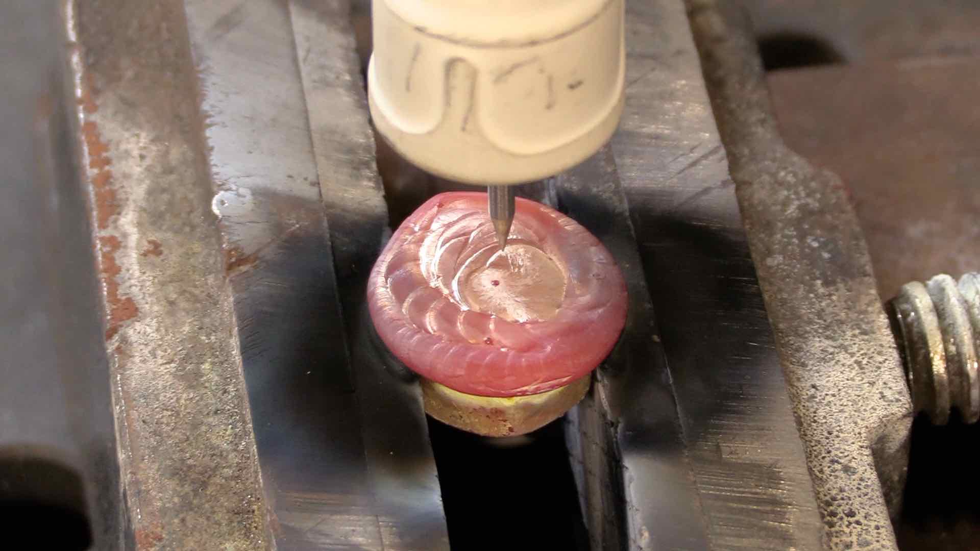

Then I buttered the surface to be welded with 312 TIG Rod.
1-312-stainless-tig-rod-overlay
After that cooled I sanded the surface smooth.

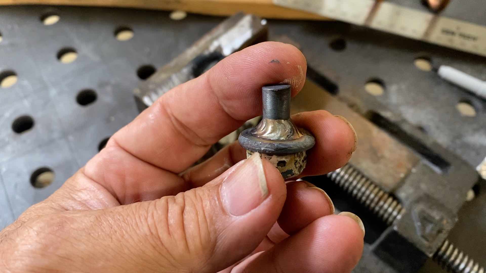

When I first tack welded the piece I let the arc heat up the pin for a few seconds as kind of a preheat.  The actual pin I welded was only around 1/2” long and only about 5/16” diameter so it got red hot quickly.
I welded the pin out using 312 stainless TIG Rod and let it cool slowly and left the weld on the pin.
1-high-carbon-pin-weld-repair
