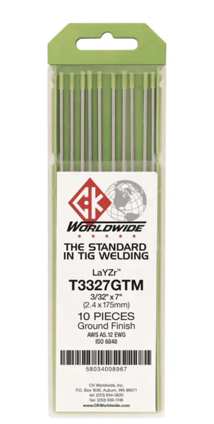

Another popular choice is CK worldwide LaYZr.  My friend Brad Goodman aka @deepsouthdimestacker loves CK LayZr tungsten.  He does a lot of aluminum in the .090” to .125” thickness range and LaYZr holds a nice consistent taper on AC at medium amperages.
Brad also welds quite a bit of stainless and 4130 chromoly.
LaYZr also works really well on DC.
E3 is another good choice and seems to perform just like LaYZr ( I can’t tell the difference in LaYZr and E3).

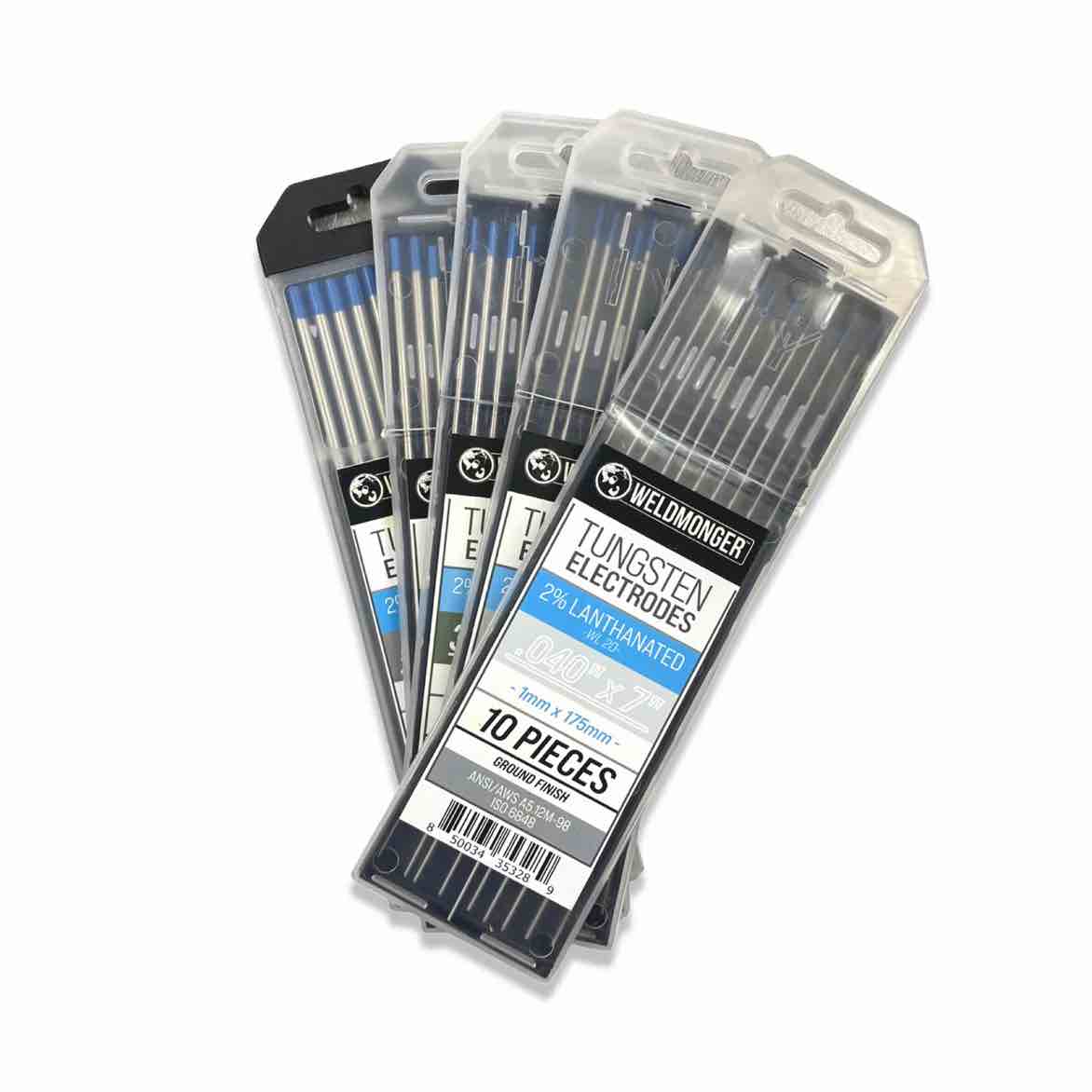

My personal go to tungsten is 2% lanthanated.  I think its a great all around tungsten I like the fact that a 3/32” tungsten can handle more amperage than most other types of tungsten on AC.  I have been using 2% lanthanated for over 10 years and it makes things simpler for me only keeping up with one color.
If you have a 200 amp tig welder a 3/32” 2% lanthanated tungsten will handle anything the welder can do from razor blades to aluminum at 200 amps.

If you had to pick only one size and type…
3/32” 2% lanthanated has higher current range than others and will pretty much handle anything a 200 amp welder can.   So that is one idea for a single size and choice.
But if you have more amps than that, a 1/8” E3 or LaYZr is not a bad choice for a single size/type tungsten for both steels and aluminum.
