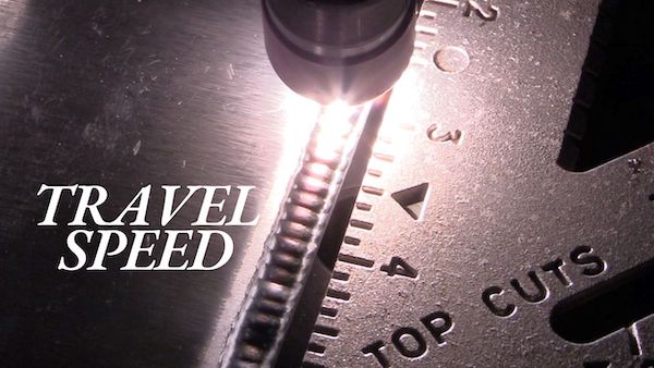

In this video, I am TIG welding beads on the outside edge of 3/16" thick 6061 aluminum with the main goal being cosmetics.
A bead just for looks for a TIG finger display
visit weldmonger.com for TIG kits, TIG fingers, TIG torches, tungsten, filler rod, gloves, tig welding machines, and more
When comes to overall heat input,  amperage makes a big difference.
But travel speed can also be one of the biggest factors.
A fairly slow travel speed is fine for learning to TIG weld aluminum.
In fact, placing a ruler next to the bead can help you keep the pace of 1/8 inch per second (which is around 7.5 inches per minute)
But eventually, you will want to increase travel speed for certain applications.
If you are in business for yourself and getting paid by the job instead of an hourly wage, increasing travel speed can make a big difference in your pay.
Final Nuggets from this video
  • A slow travel speed with medium amperage can put more heat into a part than a fast travel speed with higher amperage.
  • A fairly normal travel speed for a beginner tig welder is only about 7 inches per minute.
  • If you are just learning , concentrate on making even uniform beads and don't worry too much about travel speed. Speed comes later
  • With aluminum as well as other alloys that are prone to porosity, too fast a travel speed can contribute to porosity because impurities don't have time to outgas or escape as the puddle solidifies quickly.
  • using pulse settings of 1pps can help you establish a consistent rhythm and travel speed
