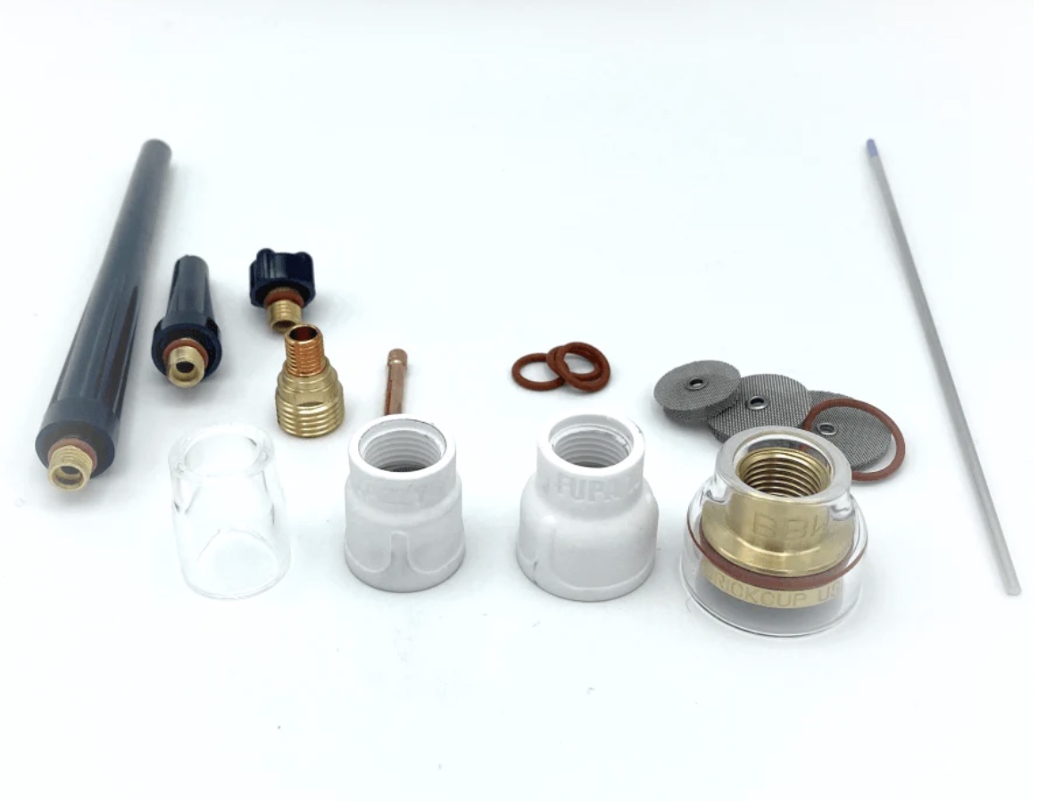

The easiest and quickest way to identify your tig torch is to take a quick look at the collet and collet body.
If your Collet body is almost 2 inches long, then you have a 17,18,26 style tig torch.
...and if your collet body is slightly less than 1 inch long, then you have a 9 or 20 style torch.

The very first upgrade I recommend for an air cooled 17 style tig torch is our Weldmonger Stubby gas lens kit
This kit comes with #4 thru #8 cups and also has a 3/32" furick gas lens with O-ring groove that lets you use clear cups and other furick gas lens cups.

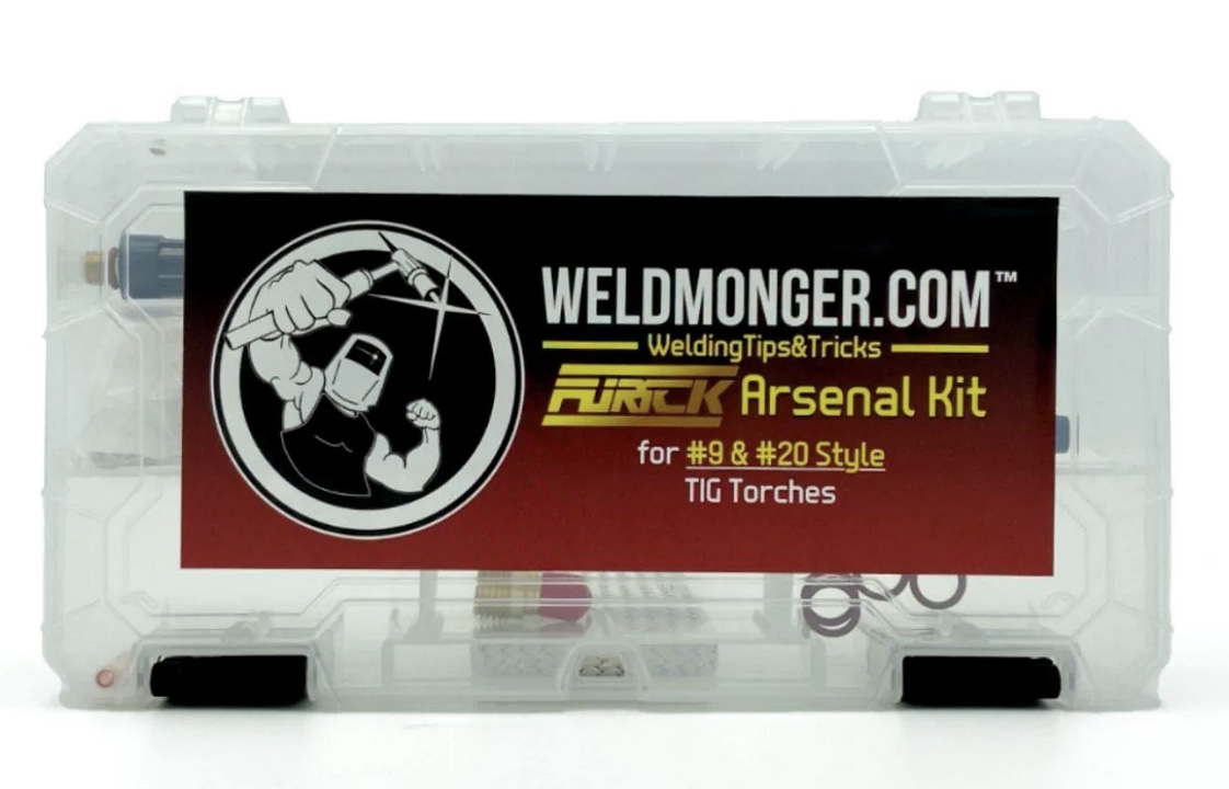

If you weld a lot of stainless, 4130 chromoly, or titanium, then a Weldmonger Furick Arsenal Kit is a game changer
Arsenal kits for 9/20 torches
