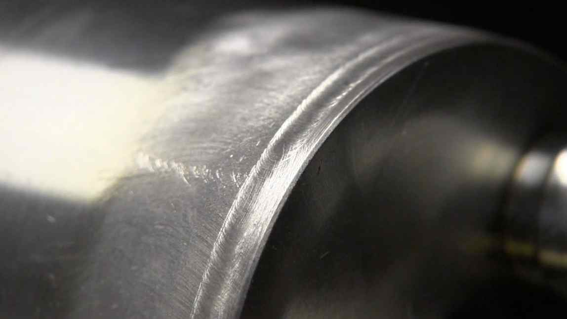

stainless steel tubing weld done on turntable using 2t settings and a timer switch

  • Semi automated jobs using a stationary tig torch and a turntable.
