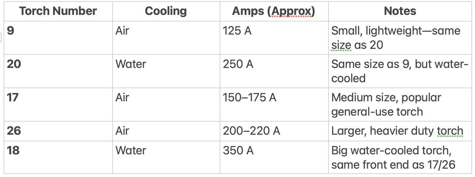

The TIG torch numbering system (like 9, 17, 20, 26, etc.) seems random to most of us welders because there’s no rhyme or reason...no pattern.
How the TIG Torch Numbering System Started
  • The numbers (e.g., 9, 17, 26, 20) were originally assigned by manufacturers like Weldcraft, when they developed new torch models.
  • Weldcraft (a brand under Miller Electric) was one of the first to mass-produce air- and water-cooled TIG torches for industrial use.
  • Over time, the industry adopted their part numbers as a the standard and torch companies still use them for reference.
  • AWS A5.12 (the specification for tungsten arc welding equipment) never defined torch numbers, so the system was left to manufacturers—leading to random numbers and inconsistency.
Simple TIG Torch Number Chart
tig-torch-numbers-chart

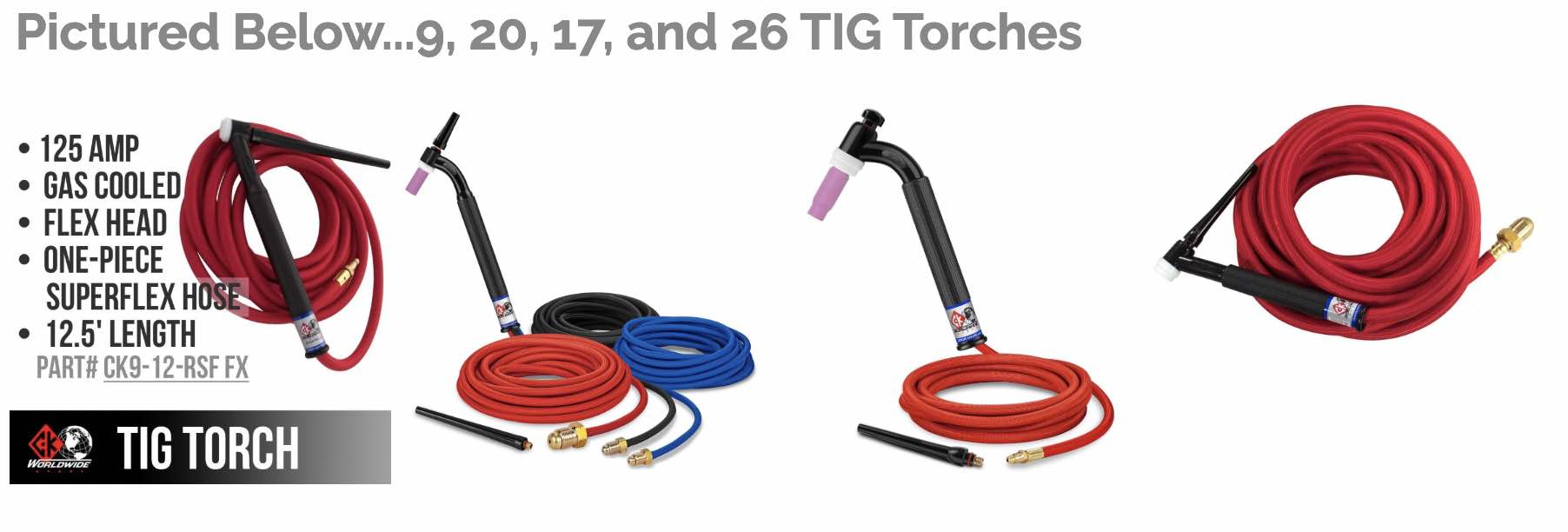

Why TIG Torches with Different Amperage ratings Use the Same Front End Hardware
  • Torch styles share front-end consumables based on size, not cooling.
  • For example, 9 and 20 use the same collets, cups, and back caps even though the 9 is an air cooled 125 amp torch and the 20 is a water cooled 250 amp torch.
  • 17, 18, and 26 also share front-end parts.
  • There are also Stubby Gas lens kits that allow using 9 and 20 torch cups on 17/18/26 tig torches.
 Both TIG torches and parts have legacy product IDs, not a systematic code. Once manufacturers like Weldcraft assigned numbers and those torches and parts became popular, the welding world adopted them—and now it’s the standard, confusing or not.

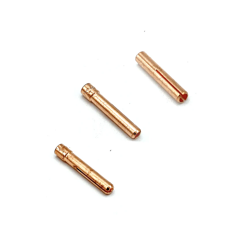

9/20 TIG TORCH PARTS
9 20 tig torch collet bodies
9/20 Tig Torch Collets
split-collets-9-20-torches
PART NAME
9/20 TIG TORCH COLLETS
LEGACY PART #
13N20 (.020”)
13N21 (.040”)
13N22 (1/16”)
13N23 (3/32”)
13N24 (1/8”)
CK part#
2C20
2C40
2C116
2C332
2C418
DESCRIPTION
Holds the tungsten inside the collet body

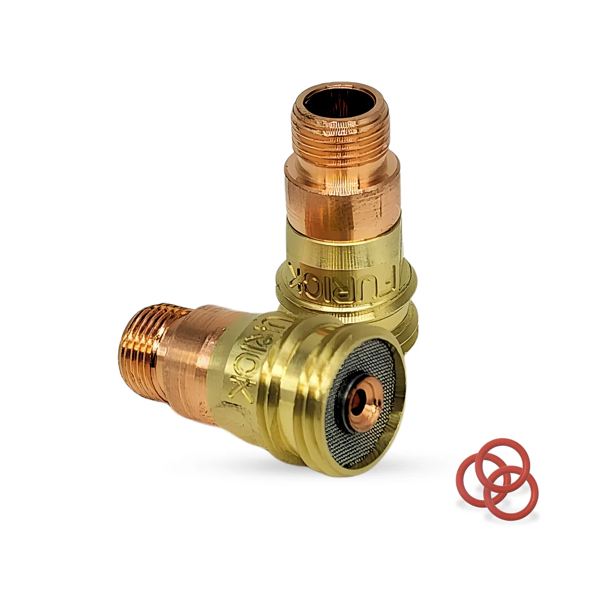

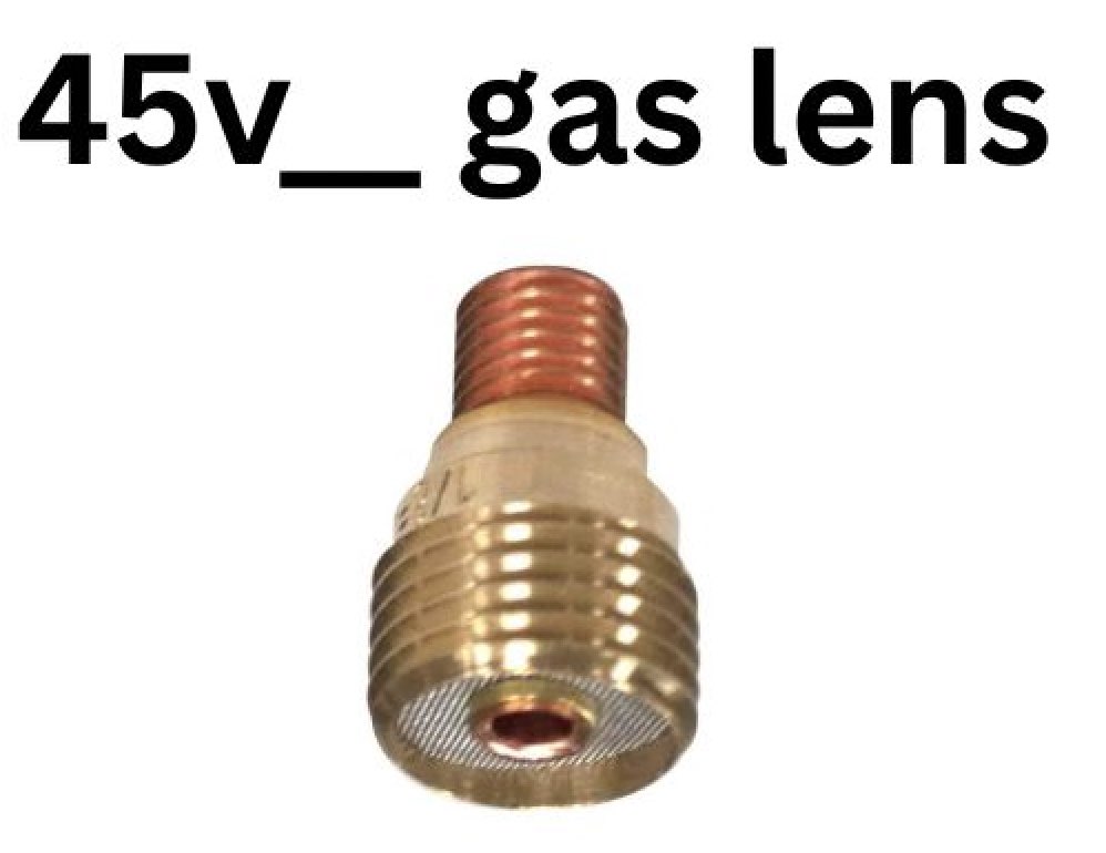

Gas Lens Collet Bodies for 9/20 style tig torches
GAS-lens-45v-9-20-torch
PART NAME
LEGACY PART #
CK part#
DESCRIPTION
Gas Lens Body
45V41 (.020”)
45V42 (.040”)
45V43 (1/16”)
45V44 (3/32”)
45V45 (1/8”)
2GL20
2GL40
2GL116
2GL332
2GL418
Improves gas flow (used instead of standard collet body)

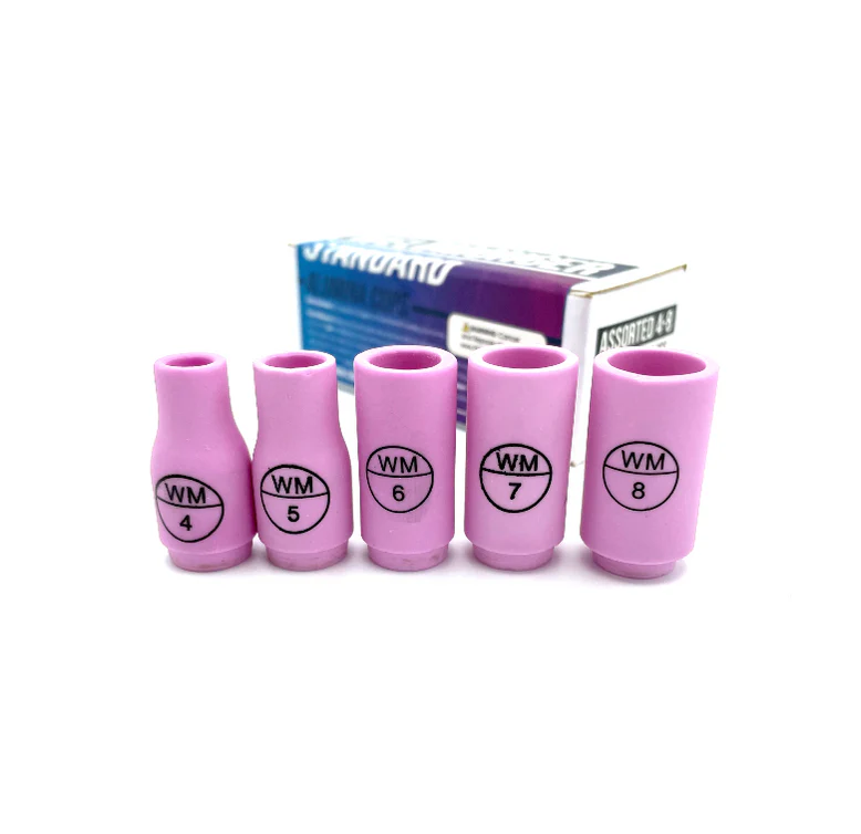

Ceramic Cups for Standard Collet bodies 9/20 torches
wm-standard-9-20-cups
PART NAME
LEGACY PART #
CK part#
DESCRIPTION
Ceramic Cups for Standard Collet body
13N08 (#4 cup)
13N09 (#5 cup)
13N10 (#6 cup)
13N11 (#7 cup)
13N12 (#8 cup)
13N13 (#10 cup)
2A4
2A5
2A6
2A7
2A8
2A10
Threads onto torch to shield weld with argon

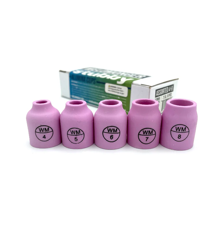

Ceramic gas lens cups for 9/20 TIG Torches
9-20-wm-stubby-cups
PART NAME
LEGACY PART #
CK part#
DESCRIPTION
Ceramic cups for Gas lens body
53N58 (#4 cup)
53N59 (#5 cup)
53N60 (#6 cup)
53N61 (#7 cup)
53N61S (#8 cup)
2A4
2A5
2A6
2A7
2A8
2A10

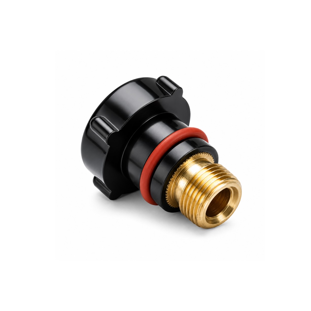

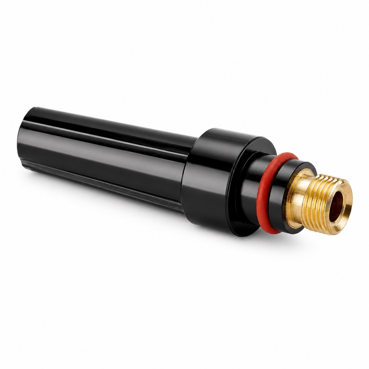

Back Caps for 9/20 TIG torches
longbackcap-9_20_650x666
medbackcap-9_20_650x666
shortbackcap-9_20_650x666
PART NAME
LEGACY PART #
CK part#
DESCRIPTION
Back Cap
41V24 (long)
41V35 (med)
41V33 (short)
200L
200M
200S
Seals back of torch and clamps tungsten

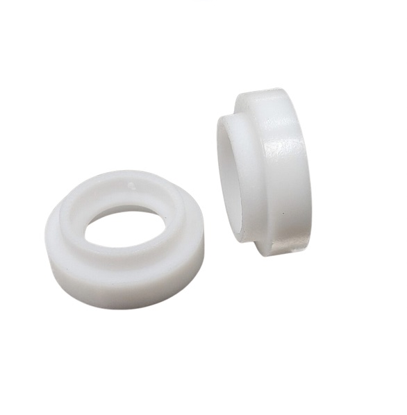

Heatshield insulator for 9/20 Tig torches
insulator-9-20
PART NAME
LEGACY PART #
CK part#
DESCRIPTION
Torch Insulator
598882
GHS 2
Sits behind the cup, insulates the head

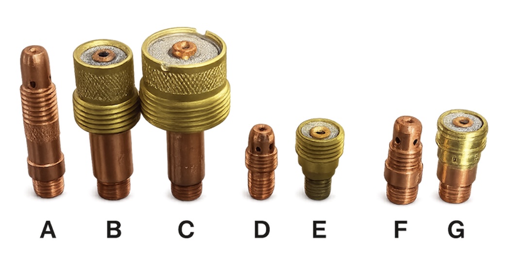

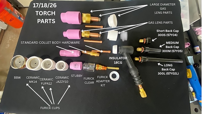

17/18/26 style TIG Torch Parts
17-tig-torch-standard-v-8-pro-clear
colletbodies
A - standard collet body for 17, 18, 26 style torches
B - gas lens collet body for 17, 18, 26 style torches
C - large diameter gas lens collet body for 17, 18, 26 style torches
D - standard collet body for 9 & 20 style torches
E - gas lens collet body for 9 & 20 style torches
F - Standard stubby 4CB collet body for  17, 18, 26 style torches
G - Furick Stubby Gas lens for 17, 18, 26 style torches

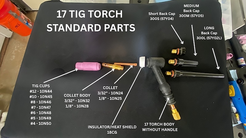

A 17 is an air cooled tig torch rated for 150 amps and is the most common tig torch included with 225 amp and under tig machiness.
An 18 TIG torch is a water cooled version of the 17 and uses the same cups and hardware as a 17
A 26 torch is a 200 amp tig torch that uses the same cups and hardware a a 17 or 18 but requires a different torch cable than the 17 due to different threads.
Furick stubby gas lens for 17 18 26 torches
FurickGasLensfor17_18_26TorchesStubby
17/18/26 TIG torch split collet part numbers
ck-10n24-split-collets
17/18/26 Torch Part name
Legacy Part Number
CK part#
Description
Collet
10N21 (.020”)
10N22 (.040”)
10N23 (1/16”)
10N24 (3/32”)
10N25 (1/8”)
54N20 (5/32”)
3C20
3C40
3C116
3C332
3C418
3C532
17/18/26 TIG torch standard collet body part numbers
collet-body-17
Legacy Part Number
CK part#
Description
Standard Collet Body
10N29 (.020”)
10N30 (.040”)
10N31 (1/16”)
10N32 (3/32”)
10N28 (1/8”)
406488 (5/32”)
3CB20
3CB40
3CB116
3CB332
3B418
3CB532
Screws into the torch head and grips the collet
Gas Lens Collet Body part numbers for 17/18/26 torch
Legacy Part Number
CK part#
Description
Gas Lens Body
45V29 (.020”)
45V24 (.040”)
45V25 (1/16”)
45V26 (3/32”)
45V27 (1/8”)
45V28 (5/32”)
3GL20
3GL40
3GL116
3GL332
3GL418
3GL532
Ceramic Cups for Standard Collet body for 17/18/26 torches
Legacy Part Number
CK part#
Description
10N50 (#4 cup)
10N49 (#5 cup)
10N48 (#6 cup)
10N47 (#7 cup)
10N46 (#8 cup)
10N45 (#10 cup)
10N44(#12 cup)
3A4
3A5
3A6
3A7
3A8
3A10
3A12
Ceramic Cups for Gas Lens Body 17/18/26 torch
Legacy Part Number
CK part#
Description
54N18 (#4 cup)
54N17 (#5 cup)
54N16 (#6 cup)
54N15 (#7 cup)
54N14 (#8 cup)
54N14-10 (#10 )
3AG4
3AG5
3AG6
3AG7
3AG8

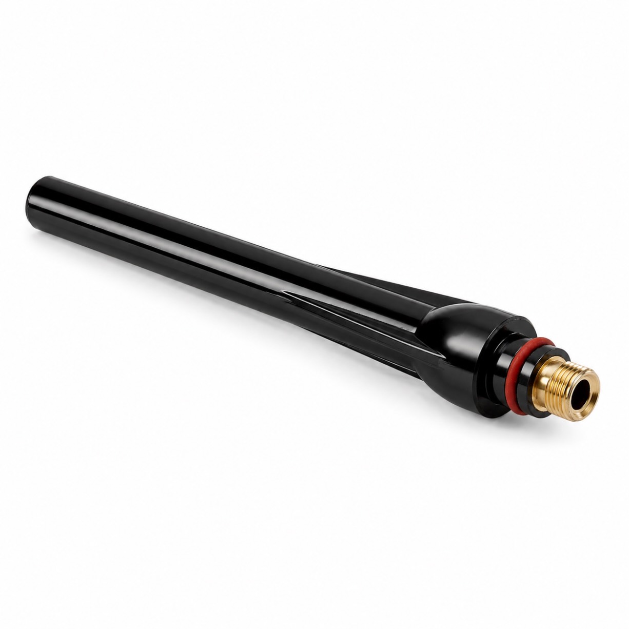

Back Caps for 17/18/26 tig torches
Legacy Part Number
CK part#
Description
Back Cap
57Y02 (long), 34015 (medium), 57Y04 (short)
300L
300M
300S
long-back-cap-300-17-WM57Y02L
mediium-back-cap-300-17-WM57Y05
short-back-cap-300-17-WM57Y04
Torch Heat Insulator 17/18/26 torches
Legacy Part Number
CK part#
Description
Torch Insulator
18CG for std collet body
54N01 for gas lens body
300HS std
3GHS gas lens body
