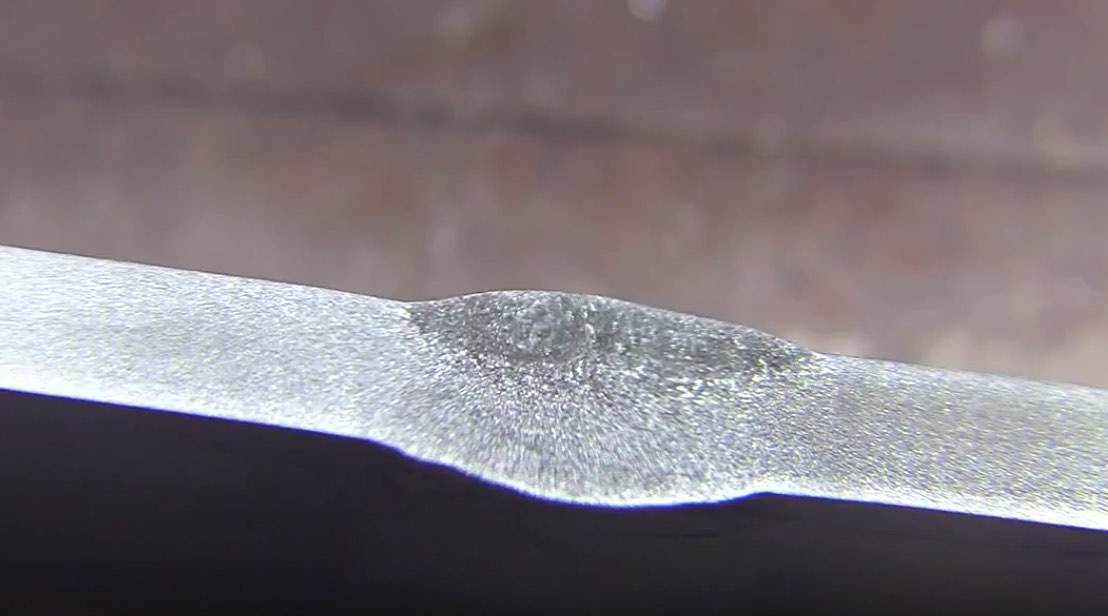

This video shows techniques, arc shots, and tips for how to tig weld an open butt root in 11ga steel.
The weld in the video was done in the flat (1G) position but these same techniques will work in all positions with minor adjustments.

Joint details for this TIG Weld
11ga Cold Rolled aisi 1010-1018 steel
30 degree bevel
3/32" (2.4mm) gap
.030" (.75mm) land
Root pass lay wire using 3/32" wire 90-100 amps
Second pass using 1/8" wire 100 amps
2% lanthanated electrode 3/32"
#8 clear furick Cup and 20 cfh argon
Cut and Etch
There is always a chance of lack of fusion when making a multi pass weld.
So I like to test welds often to verify what I thought I saw vs actual results revealed by the cross section.
I used a zip wheel on a grinder followed by a 80 grit flap disc, followed by a 2 scotch brite pads to get the surface smooth enough to etch without any deep scratches that might conceal defects.
I etched using a passivation solution made for stainless steels.
