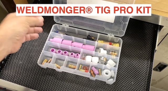

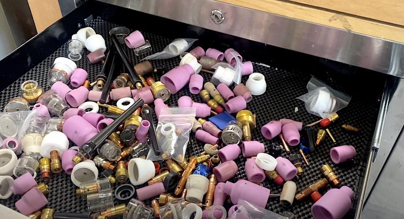

Sometimes my TIG cup Drawer Situation gets out of hand...
Our TIG Pro Kit helps keep me Organized
tig-cups-messy-drawer
TIG-PRO-KIT-DRAWER-TEXT

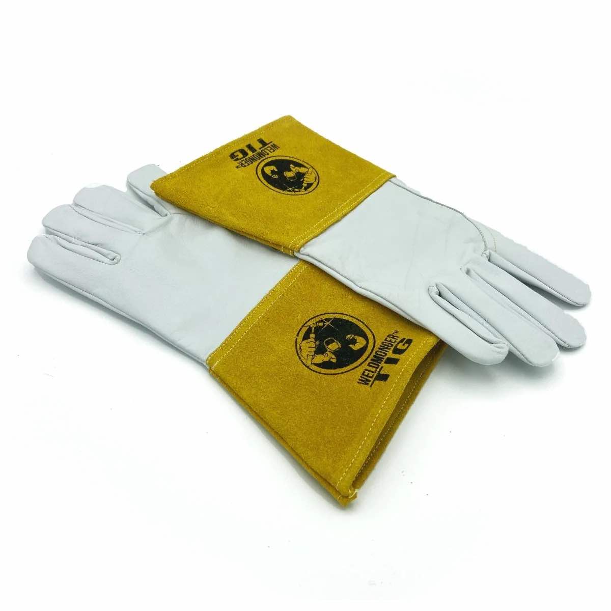

  2. TIG Gloves
    • Thin goatskin or deerskin for better control and feel
