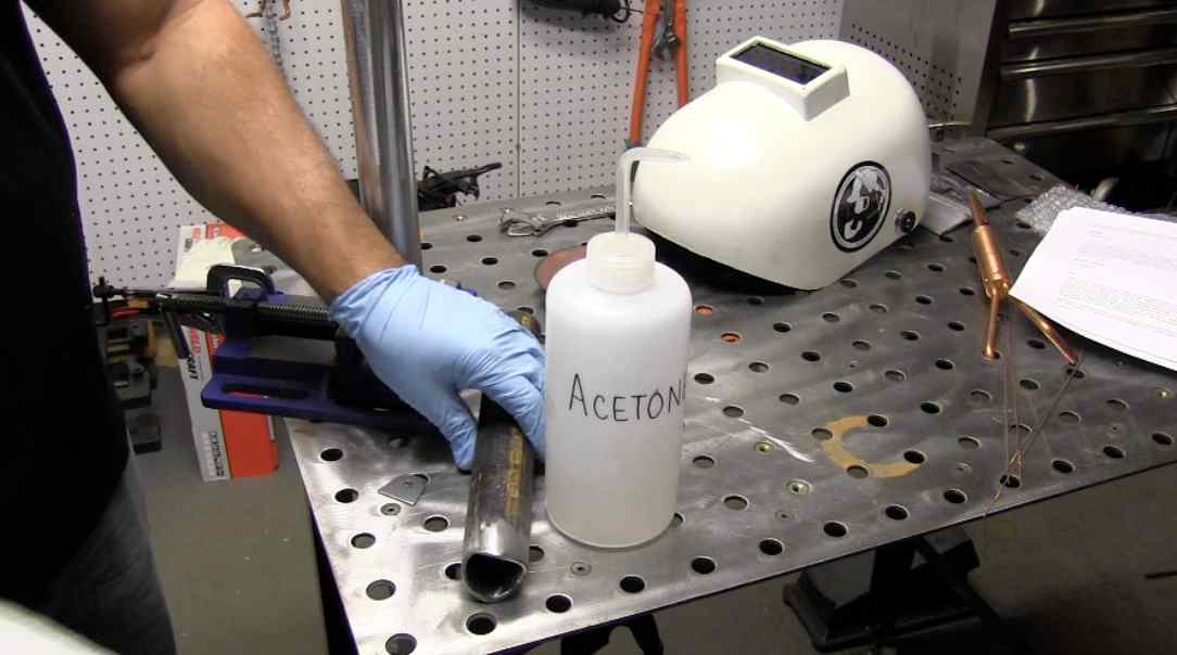

TIG weld only on clean bright metal.
"Clean bright metal" means bare metal that is free from heavy oxides, oil, grease, paint, or coatings.
For stainless steel and aluminum, that could mean a simple wipe with acetone.
But for hot rolled steel and chromoly, more prep might be needed.
The pipe I welded in this video had a coating on the surface.
I sanded it down to clean bright metal and then wiped with acetone to remove any residue.
again, for stainless steels and aluminum, sometimes you are pretty much looking at clean bright metal. ( except for a thin oxide film) and all you need is an acetone wipe prior to welding.

Wiping with a solvent before welding
The video shows how much residue is left over even after the metal appears to be clean.
Acetone and Alcohol are 2 commonly used solvents that work well to remove oils and residues and that also evaporate quickly.
One place where I worked years ago even used some type of freon as a degreaser solvent but I am pretty sure they have discontinued that practice due to EPA issues.
Its also good practice to give the filler rod a good wipe down with acetone. There can be drawing compounds on tig filler wire.
