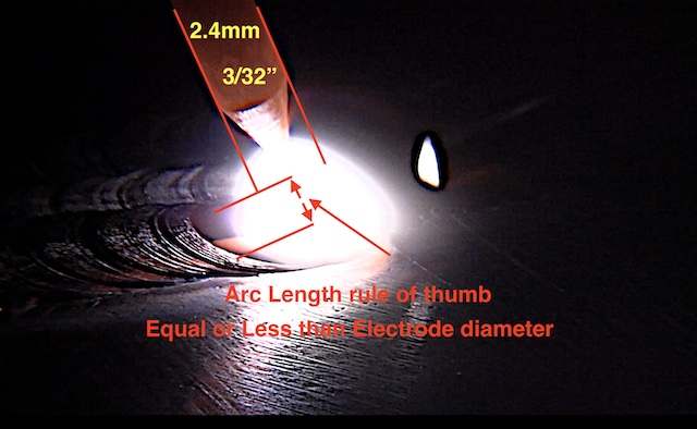

ARC LENGTH
tig arc length
For tig welding carbon steel an arc length that is equal to or less than the electrode diameter is a good rule of thumb.
In the image above you can see that the arc length is slightly less than the 3/32" (2.4mm) tungsten diameter.
The thinner the metal, the tighter the arc should be. Generally speaking
Keep in mind that is just a rule of thumb... there are always exception in welding.
