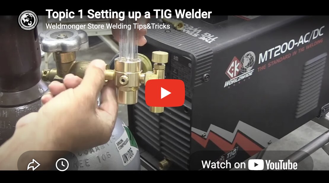

TIG Welding for Beginners
Start Here...Watch the Video
setting-up-tig-welder-ckmt200-thumb
This is the first in a series of videos and articles titled TIG Welding for Beginners
Here is what you can expect to learn:
  • TIG Welding Fundamentals
  • What TIG welding machine to buy
  • Power requirements ( and how that affects your decision on which TIG welder to buy)
  • Which features you need and don't need.
  • TIG torches
  • TIG cups
  • Tungsten electrode tips
  • Shielding Gas
  • Welding your first beads

When starting out, you only need one type and sized tungsten electrode.
And that is 3/32” 2% lanthanated.
2% lanthanated is a great all purpose tungsten that works great for both AC and DC welding.
That means it works on all metals with no need to change tungsten.
Tungsten electrodes are color coded on one end and since you will often need to trim the tungsten to fit certain applications, you wind up with short pieces that do not have the color band on the end.
IF you stick with 2% lanthanated you will always know what type tungsten you have.
Later down the road, you might discover some very specific applications where other types of tungsten are slightly better but I personally use 2% lanth for everything.
A 3/32” diameter 2% lanthanated tungsten has an amperage range up to around 200 amps so it might be the only size you ever need.

Regulator flowmeters
Most tig welding machines come with a simple single flowmeter.
I personally like the ball type as opposed to the dial.
And I also like to install a dual flowmeter for purging stainless steel, titanium and other alloys.
The single flowmeter is fine at first and if you have more than one cylinder of argon , you can use 2 separate flowmeters…one for purging if you need to later down the road.
Its good to have one of those pea shooter type flow testers too. To make sure the gas flow rate coming out of the end of the cup matches what the flowmeter reads.
