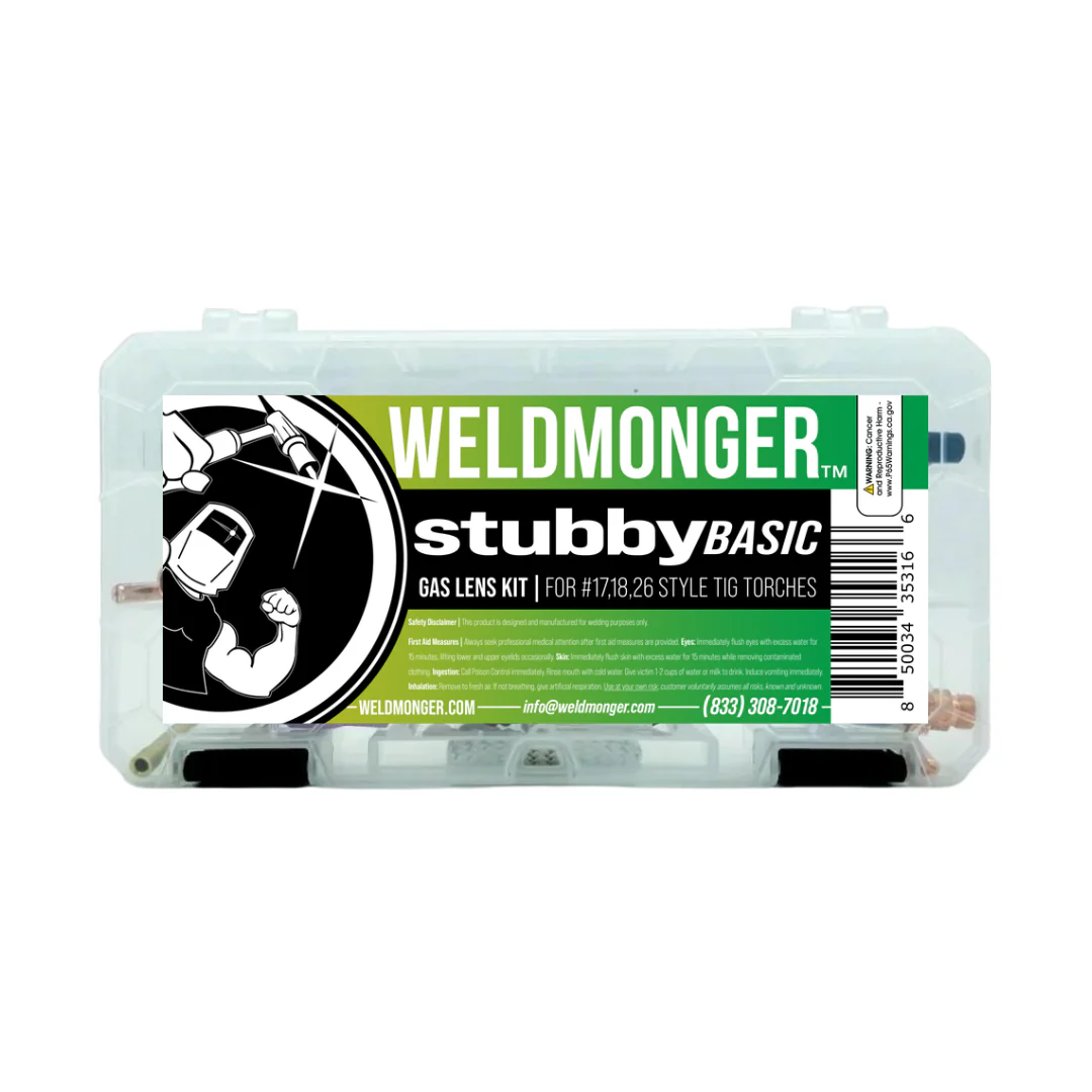

Our Basic Stubby gas lens kit is our most affordable stubby kit
basic-stubby-label

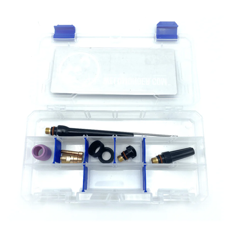

If you have never tried a gas lens with your TIG torch, this kit lets you dip your toe in the water with only 3/32" hardware
basic-stubby-contents
