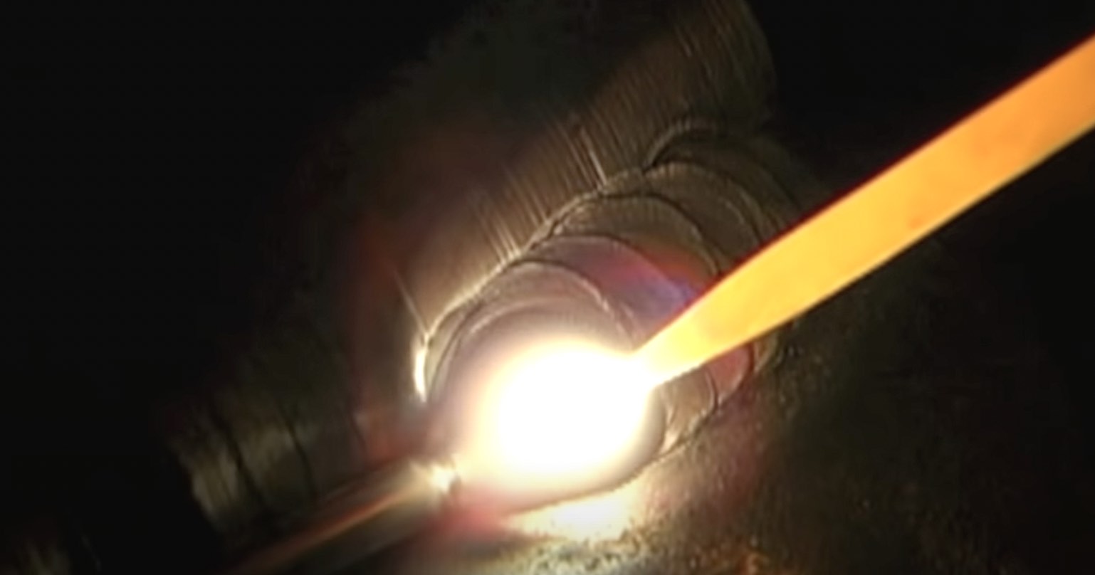

tig welding hss long stick out

This weeks video is no exception. I thought it would be interesting to pretend these parts were stainless and to go thru the steps needed to limit discoloration.
Even though these parts are high strength steel and not stainless steel, the same principles apply for limiting discoloration.
Today, I used a one inch diameter tig cup along with a piece of copper to weld one of these parts just to show how it helps on weld discoloration.
I see a lot of questions on forums about how to tig weld stainless steel headers and exhaust collectors, turbo tubing, etc without it turning grey.
Using a bigger cup helps a lot on welding stainless steels and steels of all types.  But its not always needed and since a bigger the cup uses more argon , its not something you want to do all the time....even though its tempting because it makes your welds come out looking better.

Settings for this job are as follows:
90 amps dcen
1/16"  (1.6mm)  2 % lanthanated tungsten electrode
1/16" (1.6mm)  er70s-3 filler rod
1" id cup using 25 -30 cfh argon
or #7 cup using 15 cfh argon
Another use for a big tig cup like this is for welding stainless headers and exhaust systems, there are welds in collectors where the angle is so tight that even the smallest tig cup will not allow access.
In situations like this, being able to extend the electrode out really far like 1 1/2" usually allows a welder to reach the weld while maintaining good argon coverage.
Yes it uses more argon, but when you need a big cup, you need a big cup.
Here are some basic tips for preventing discoloration on steels and stainless steels and titanium:
use a big cup, limit heat input, increase cooling rate, and establish a puddle quickly and get moving to prevent heat buildup.
