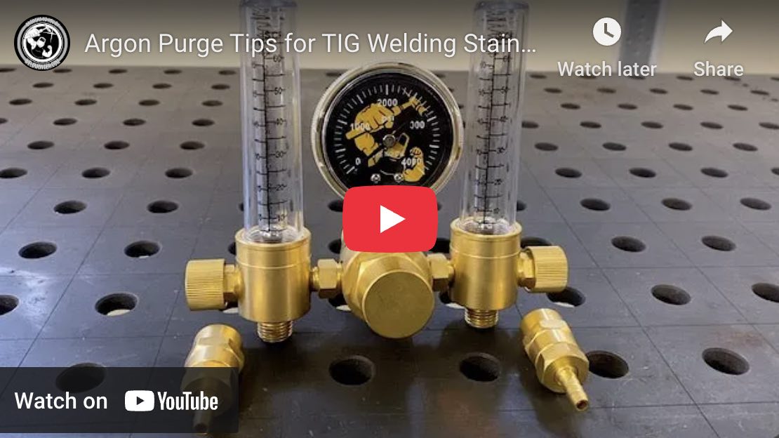

argon-purge-tips-thumb-wm-dual
Sanitary Stainless TIG welding uses pure argon
Industry where TIG welding stainless is common is sanitary stainless tubing welding for food and beverage..and also pharmaceutical.
For sanitary stainless tig welding, the main thing is quality of the purge and the surface of the root on the inside diameter.
This requires a good argon purge as well as the right amperage and right technique.
