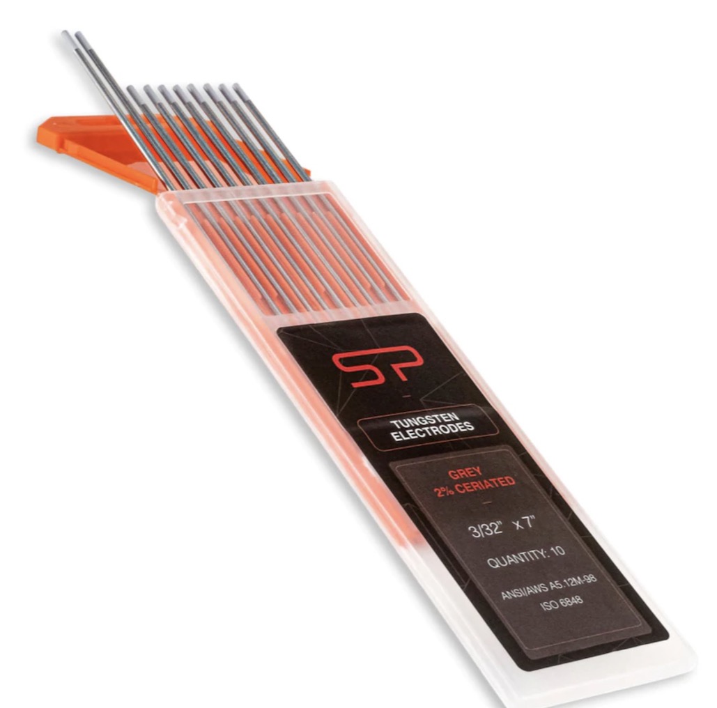

2% Ceriated (Gray)
2% ceriated tungsten is a great choice if you mostly do DC welding and occasionally do AC low to mid amperage welding.
Its a pretty good non radioactive alternative to 2% thoriated.
It holds a good point for DC and at low to mid amps on AC holds a nice tip ( provided you round it intentionally) on low to mid amps on aluminum and magnesium.
The main drawback is the lack of high amperage carrying capability.
for that you might go with....you guessed it.

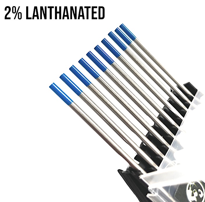

2% lanthanated
2% Lanthanated (Blue)
2% lanthanated has been my all around, all purpose, one stop shop tungsten for over 10 years.
In my opinion, its a really good non radioactive alternative to 2% thoriated.
Pretty much everything I have tig welded since 2011 has been with 2% lanthanated tungsten.
I welded a lot of different metals since then and lots of different thicknesses but 2% lanthanated worked on all of it.
Sure there were probably times where other tungsten electrodes would have been slightly better, but having only one type of tungsten in my tool box made life simpler for me.
