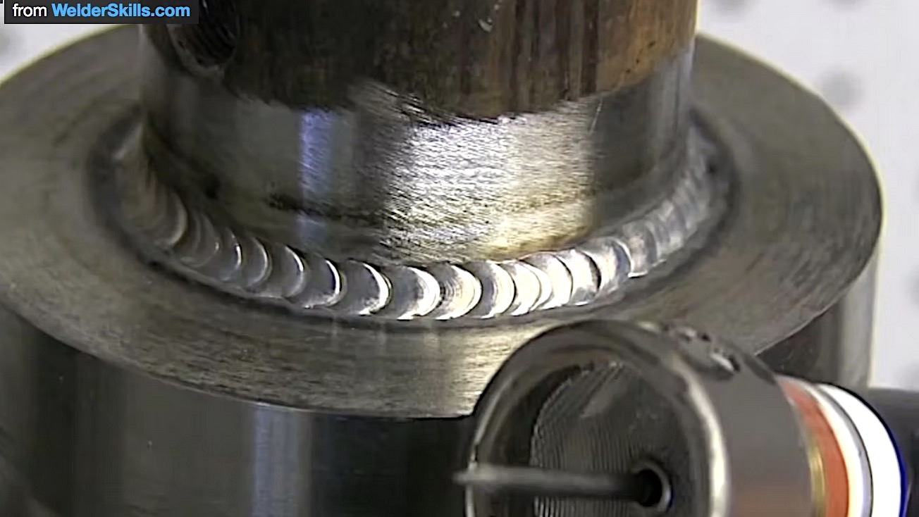

TURNTABLE WELD SETTINGS USING 309 FILLER
scroll down for details and settings
WELD PROCESS = TIG, GTAW, GAS TUNGSTEN ARC WELDING,
METAL TYPE = HIGH STRENGTH STEEL TO 304L STAINLESS STEEL
THICKNESS = 1/2’ TO 3/4"
WELD TYPE = FILLET
JOINT TYPE = TUBE TO PLATE
POSITION = TURNTABLE
AMPERAGE = MACHINE SET TO 150 AMPS CONTROLLED WITH FOOT PEDAL
FILLER WIRE = 3/32” ER309L
POLARITY = DCEN
GAS FLOW =25 CFH argon
CUP SIZE = 12
ADDITIONAL SETTINGS =
PRE FLOW = .2 SEC
POST FLOW = 11 SEC
TIPS: Aim for an arc length that is equal or less than the diameter of your tungsten electrode. Torch angle can be forgiving provided your arc length is tight.
