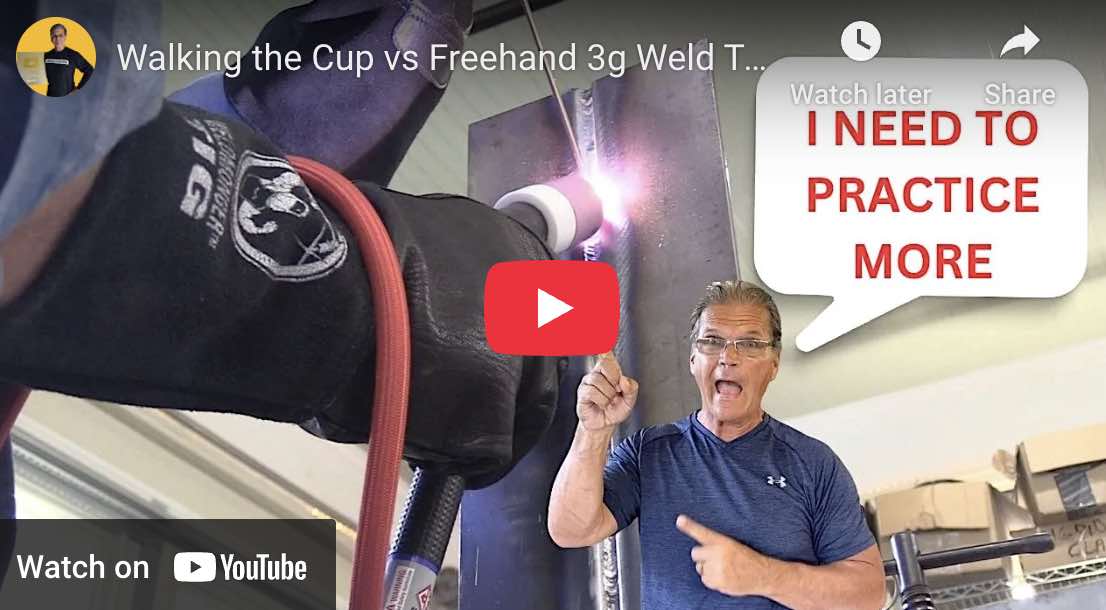

Walking the Cup TIG Welding
Walking the Cup TIG Welding vs Freehand
walking-the-cup-freehand-thumb
If you are trying to learn how to walk the cup, the video above is one of the best ones you will find and will give you a Huge jump start on walking the cup tig welding.

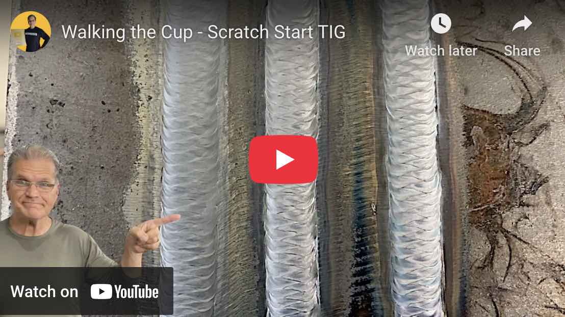

Practice Walking the Cup TIG welding Scratch Start
New to Walking the cup and Scratch Start TIG? Watch this video for Tips

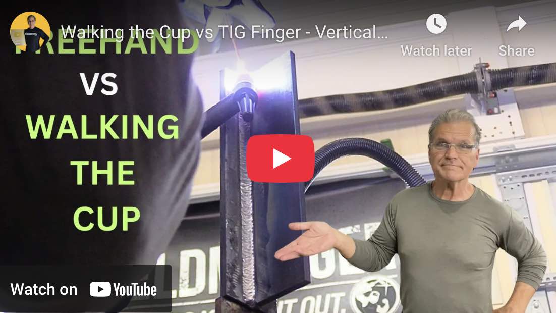

Vertical Fillet Weld Walking the Cup Practice
If you are in welding school, this video on walking the cup will give you a head start for walking the cup on plate, pipe, and welding socket welds

3G plate Walking the Cup Practice
Some Fab shops give this test to new hires
3G-walk-cup-thumb
