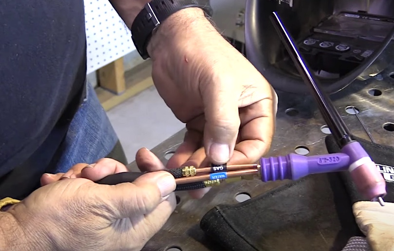

A water cooled tig torch uses a tig cooler to circulate water or coolant liquid thru the torch and hoses to keep it cool.
A water cooled torch also lets you use a smaller torch for higher amperages than you could with an air cooled tig torch.
A water cooled tig torch typically has 3 hoses.
One for argon, one for the power cable, and one for the water return.
The tig cooler usually has some type of heat exchanger that resembles a small radiator that keeps the water or coolant from getting too hot.
Some tig coolers rely on volume and strictly have a reservoir that holds 5 gallons or so of liquid.
If you have enough volume in the reservoir, the torch stays cool enough.

A water cooled tig torch is a must for high amperage applications
If you weld a lot of aluminum over 1/8" thick, you probably go over 200 amps a lot.
And if you fabricate something like EMT vehicles using 1/4" thick tread plate, you might even be well over 300 amps.
A water cooled tig torch is a must for high amperage tig welding.
There are 2 main styles of water cooled tig torches.
a 20 style is a water cooled version of a 9 air cooled and is also referred to as 2 series by come companies like CK.
an 18 style is a water cooled version of a 17 or 26 air cooled tig torch.
and is also referred to as 3 series by come companies like CK.
