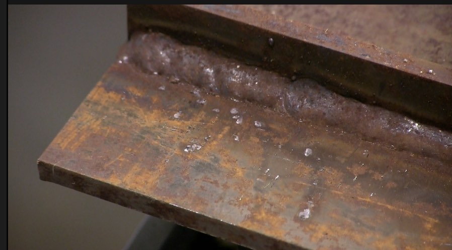

Well, I got to thinking about my very first welding job the other day and how removing spatter was part of that job.
I welded some high strength steel parts on that job with 3/16" 11018 stick rods.
Sometimes, when turning a corner, arc blow would cause some serious BBs  and they were really hard to remove...even with a hammer and chisel...and some areas were really hard to reach with a hammer and chisel.
High strength steel sometimes have a really nice finish like cold rolled.
and spatter really can stick to that finish a lot more than hot rolled mill scale finishes.
That got me to thinking that maybe a slide hammer attached to a wide chisel might be useful for removing spatter.
weld spatter
spatter removed with slide hammer chisel
