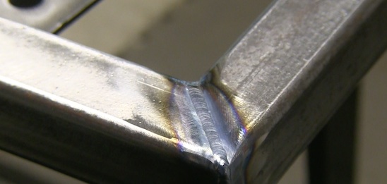

The only slight problem is that it has some light rust on it from being outside for a month or two. So I decided to try a 3M bristle disc on it to remove rust and hot rolled mill scale and it worked out great.
A friend of mine (Roy Crummy Crumrine) told me about this product and I found one on Amazon for around 25 dollars so I got one.
I have tried lots of different disks and wheels to remove mill scale and most of them load up after only a few minutes and then quit working. A wire wheel works ok from removing light rust but for mills scale, a wire wheel just does not work very well ... and besides it slings wire bristles and sticks in your clothing in the worst possible places.  You feel me?
But this 3M bristle disc is a different animal. It does not load up. The one I used was a brown 36 grit and I think it has ceramic particles embedded in the splines.
As long as you don't catch an edge it lasts a fairly long time. And does a great job removing mill scale and never loads up.
I dont think it would work on really heavy mill scale like you find on hot rolled plate but square tubing mill scale is usually pretty light

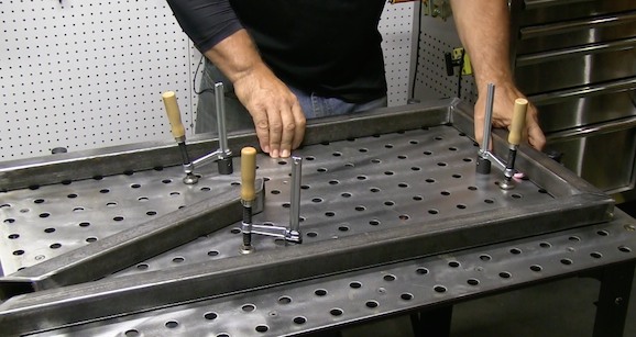

I am using a Stronghand fixture point welding table. And for framing small projects like this it is a time and work saver. If I had to do 50 of these it would really save a ton of time.
The Fxturepoint table is a light duty modular fixturing table.
It's much lighter duty than the heavy duty BuildPro table with a thinner table top and the holes are punched instead of machined.
So accuracy is not quite the same as the heavier duty build pro table.
However, it's pretty darn accurate.
Fixturing the bottom shelve of the welding cart
And it's very easy to set up a 90° angle anywhere on the table and clamp down anywhere on the table as well. My frame came out dead nuts square.
The dimensions of the base of this welding cart are 36" x 18" so you can see that pretty much takes up the entire length of the table top.
