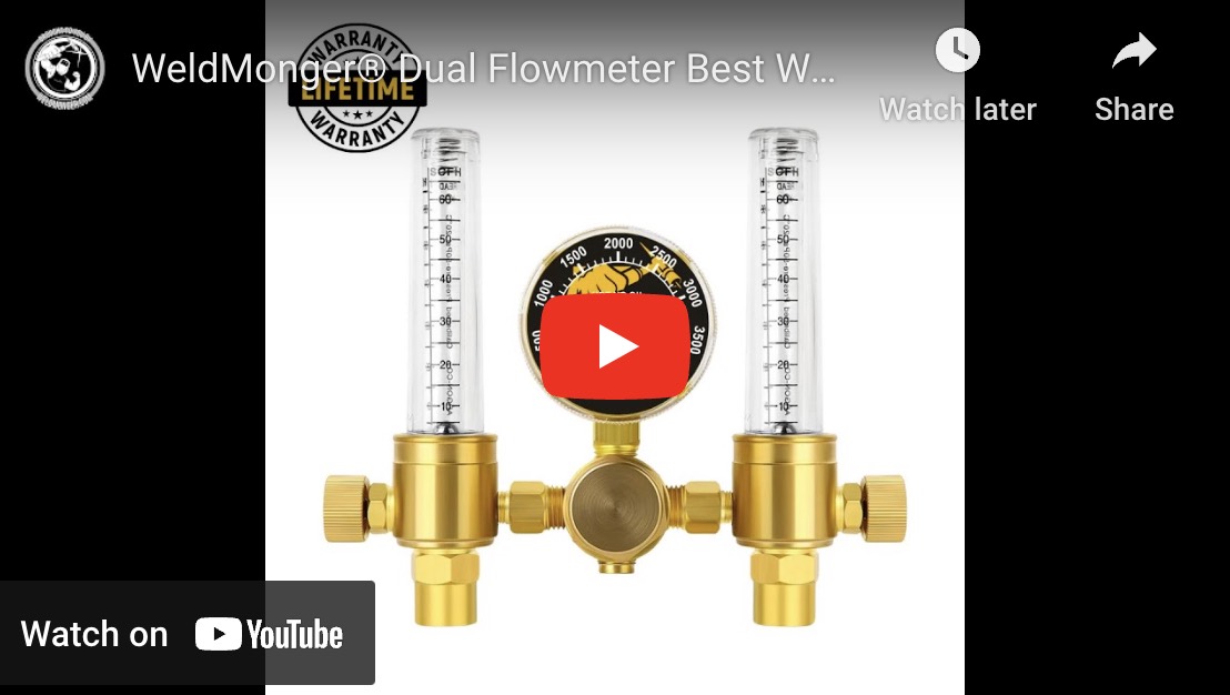

But the one thing you need to make all this happen once you make your purge box is a dual flowmeter.
...Or if you have 2 cylinders of argon, 2 single flowmeters will get the job done.
