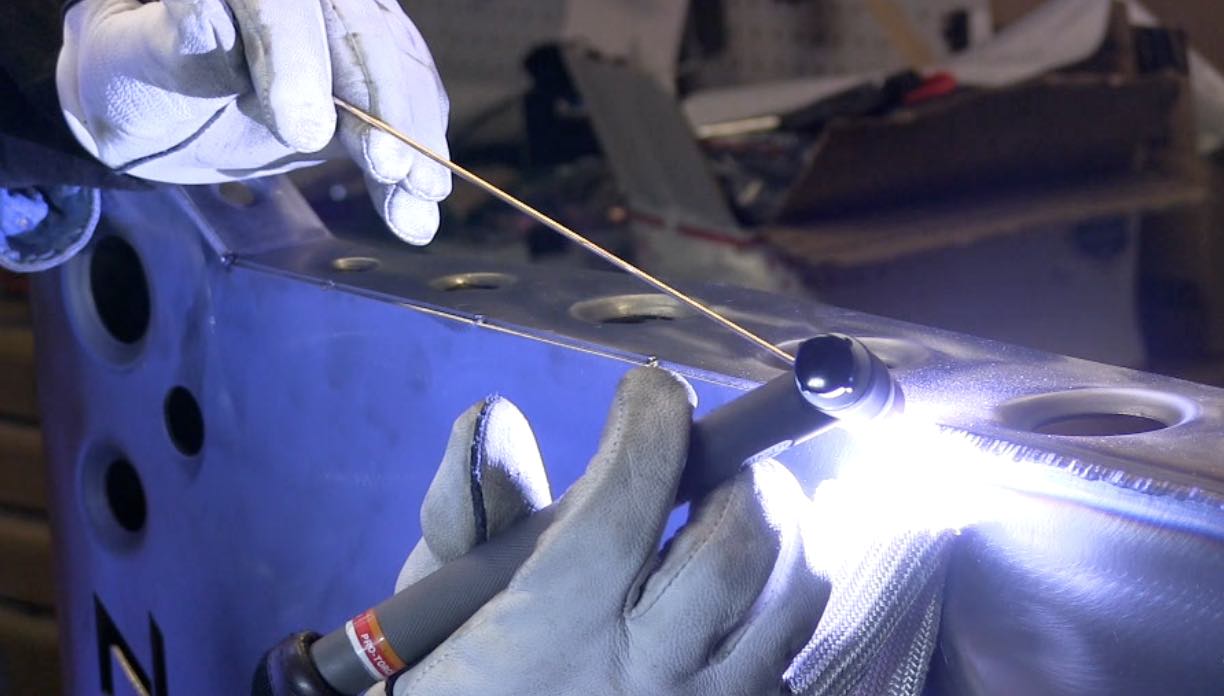

Normally, I would not use silicon bronze for a project like this but these carts are designed so well, that silicon bronze will be plenty strong enough and I wanted to get some practice and also wanted to try some pulse settings.

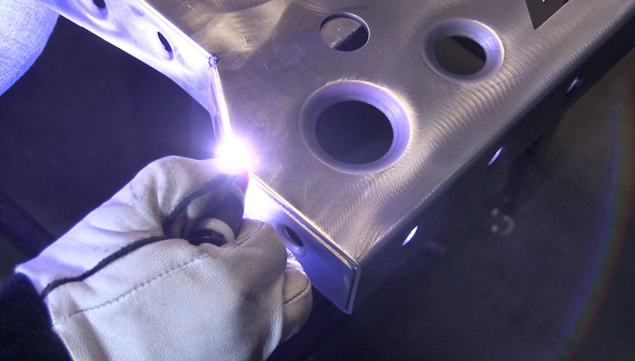

For tacking up the pieces, I used 160 amps and a quick stomp on the foot pedal. Some tig machines have a setting that allows for the foot pedal to become an on off switch that you can set for burst tacks like this....or a torch switch works great too.
This is my  preferred method of tack welding on projects like this...
I usually set the amperage to 1.5 to 2 times what I would weld with but I only use a short burst of amperage either with a torch switch or by just stomping the pedal and letting of quickly.

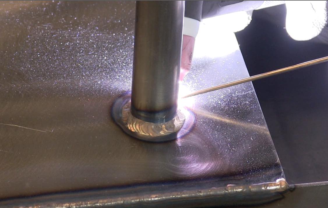

Technically, silicon bronze is a brazing rod when used on carbon steel or other metals that have a much higher melt point.
Welding actually melts the base metal
Brazing does not melt the base metal and is over 840 deg F
Soldering does not melt base metal either and is under 840 deg F
Silicon bronze filler rod has a tensile strength of around 50-60 ksi which is much lower than mild steel filler rod which is usually 70ksi minimum.
But again, the strength of this cart lies in the design.
Wall thickness on this cart is around .100" on the sheet.  I used a large fillet size with the silicon bronze filler rod to make sure I got enough strength.
Short burst fusion tacks are a quick way to tack weld using only one hand while holding the fit with the other hand.
Experimenting using 2 pulses per second and lay wire technique worked out pretty well.
The Lincoln TIG 200 square wave has pulse feature with the back ground current and pulse time being fixed at around 50% each.

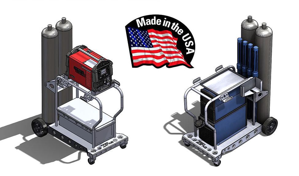

ZTfab offers welding cart kits to fit almost every tig inverter out there
There are ZTfab welding carts designed for most of the popular welding machines like the Lincoln TIG 200 square wave, and the Lincoln power mig 210mp, Miller dynasty and maxstar and more.
