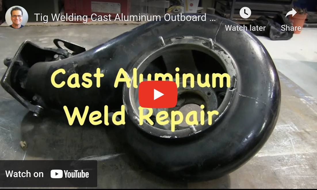

I did a weld repair on a cast aluminum outboard jet pump a while back and used 4043 for the actual repair and if worked out fine...but a few days later, I got a sample of 4943 and used it to do some arc shots for that video and I was very impressed at how it flowed on dirty oil soaked aluminum.
(but my favorite rod for cast aluminum is still 4047)

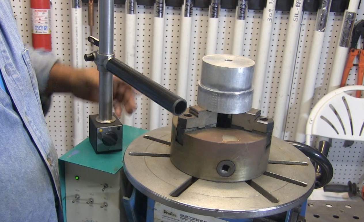

Making a DIY Prop Stand for turntable welds and for long runs
For the small amount of time and material it takes, I highly recommend making a prop stand for turntable parts and even for making long straight runs on parts.
Roy and I both take in work on round parts and we both have turntables to make those jobs go quicker and better.
A prop stand is worth its weight in gold.
Steady Rest with Magnetic base
If you are not in the mood to build your own prop stand, you can just order one.
Bill Ellert sent me his "Steady Rest" product with a magnetic base.
Its the same type of setup a machinist would use to hold a dial indicator.
I found it very useful and easy to use.
You can see Bills Steady Rest at wcedesigns.com
