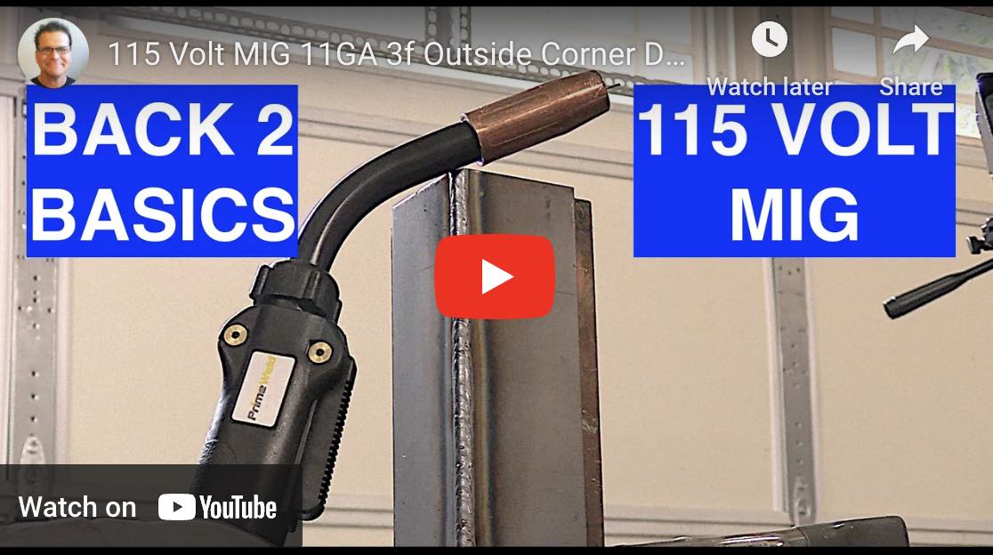

115 volt MIG Welder 11ga Corner joint 1F Flat position using a primeweld mig180
Details and settings used for this joint.
115volt mig welder - Primeweld Mig180 dual voltage mig welder
material - 11ga steel (1/8") thickness
voltage 18.1
wire feed speed set to 149 inches per minute ( much lower than recommended on chart but works better for this joint)
.035" ER70S6 wire
C25 shielding gas also called 75/25 argon/co2 gas at around 20-25 cfh
I used a PrimeWeld MIG180 for this video which is a dual voltage mig welder that runs off either 115 volt or 230 volt power.
I had it plugged in to a standard 115 volt outlet on a 20 amp breaker.
I have also used in with 230volt power but for this thickness 115 volt power works fine.
I filmed several other videos using this welder along with complete settings listed on each page and you can see those here at the main primeweld mig180 page .
Not matter what type of welder you have, I hope these videos help you learn how to use it better.
