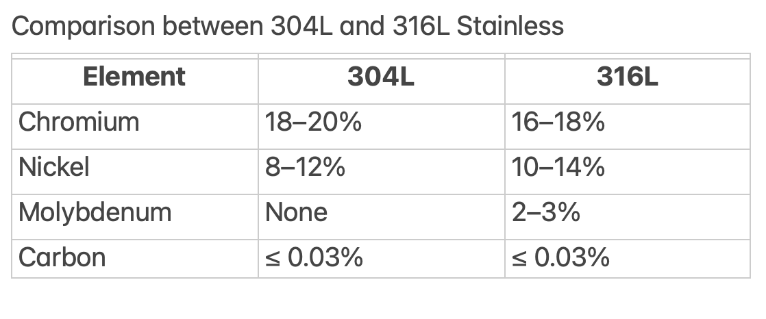

Chemical Composition
316L is an austenitic stainless steel like 304L, but with one critical addition
—molybdenum, typically around 2–3%.
This single ingredient transforms its performance in aggressive environments. Here's how the two compare in terms of composition:
304L-vs-316L-comarison-chemical
Key Differences Between 304L and 316L stainless
  • Corrosion resistance: 316L has superior resistance to chlorides and other corrosives.
  • Strength: Both are similar in strength, but 316L holds up better in harsh environments.
  • Cost: 316L is more expensive due to molybdenum and higher nickel content.

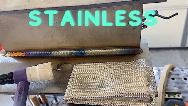

TIG Welding Preparation Best Practices
Cleaning Procedures for Both Grades
  • Remove oil, grease, and contaminants using acetone or alcohol.
  • Use dedicated stainless brushes (not carbon steel) to avoid cross-contamination.
  • 316L needs extra attention to remove surface salts or chlorides, especially in marine-related repair applications.
Shielding Gas and Gas Coverage
sanitary-thumb
Recommended Shielding Gases
  • Use 100% argon for most TIG welding.
  • some weld procedures call for a mix of argon with up to 5% hydrogen to improve weld wetting and reduce porosity (experienced welders only).
Gas Flow Rates and Coverage Strategies
  • Torch gas flow rates depend mostly on type and size of TIG cup. 2-3 CFH (cubic feet per hour) per cup number will usually get you right in the ball park but other factors like joint type, and wind can affect the flow rate needed.
  • Use a gas lens on the TIG torch to ensure even gas coverage and to allow for longer stickouts when needed
Back Purge Requirements
  • Both 304L and 316L require back purging when welding tubing, piping, or any situation where the root side of the weld is exposed.
  • Argon is recommended for back purging; Flow rate depends on volume of pipe, vessel, or part being purged.
  • A dual flowmeter can come in clutch for purging.
