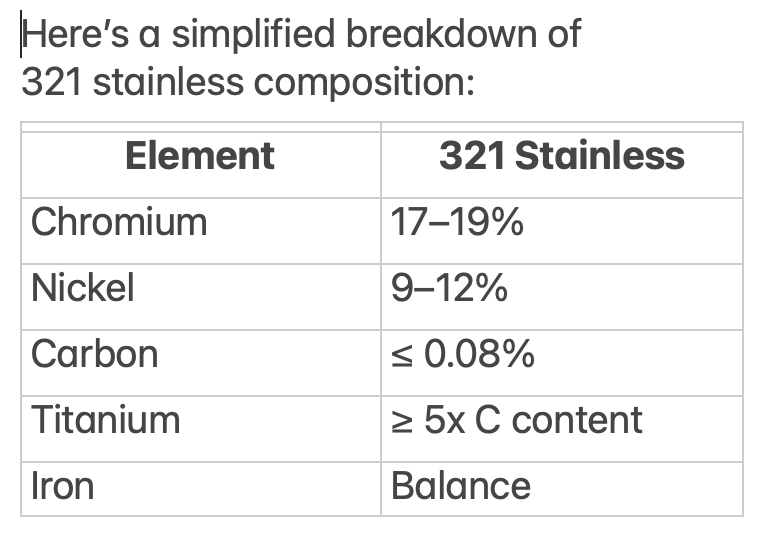

Understanding 321 Stainless Steel
321-stainless-composition
Role of Titanium in 321 Stainless
Titanium binds with carbon to form titanium carbides, which prevents chromium carbide precipitation during welding and high-temperature exposure. This stabilization eliminates the risk of intergranular corrosion—a problem 304L can face when exposed to temperatures between 800°F and 1500°F.

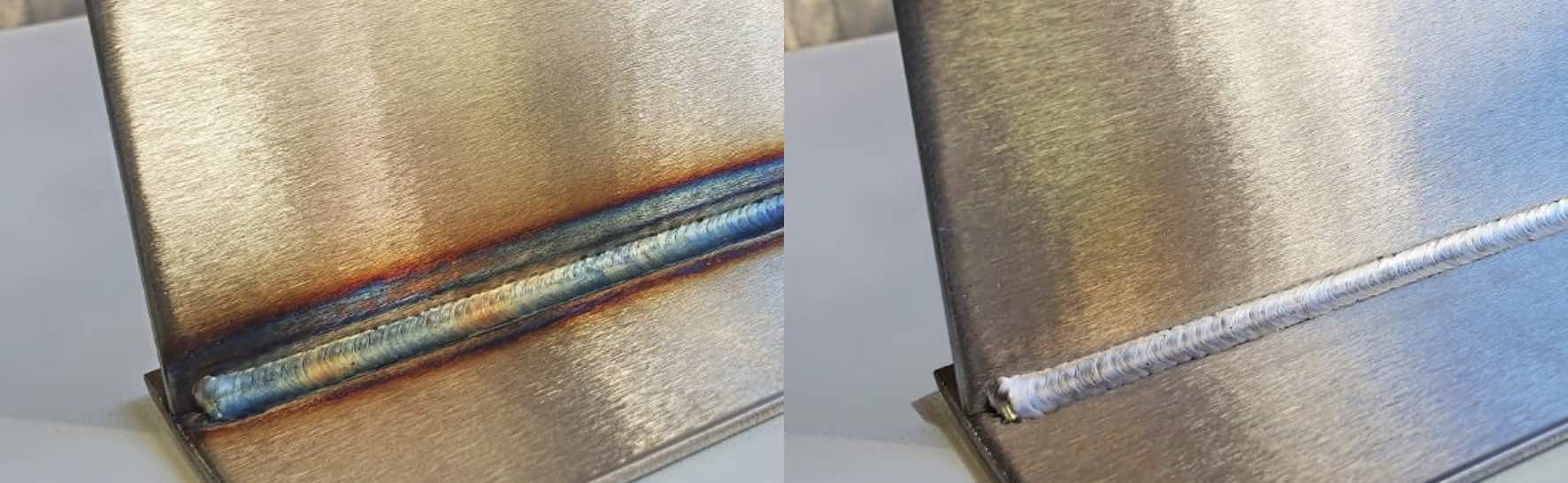

Differences Between 304L and 321 Stainless Steel
properly shielded stainless
While both are austenitic and contain similar levels of chromium and nickel, 321’s inclusion of titanium gives it the edge in high-heat applications. 304L lowers carbon to prevent carbide precipitation, but under prolonged high temperatures, 304L still risks losing corrosion resistance.

Weldability and Corrosion Resistance
Both grades are easy to weld, but 321 stainless holds its corrosion resistance even in the heat-affected zones (HAZ), whereas 304L might suffer from sensitization without additional heat treatment.

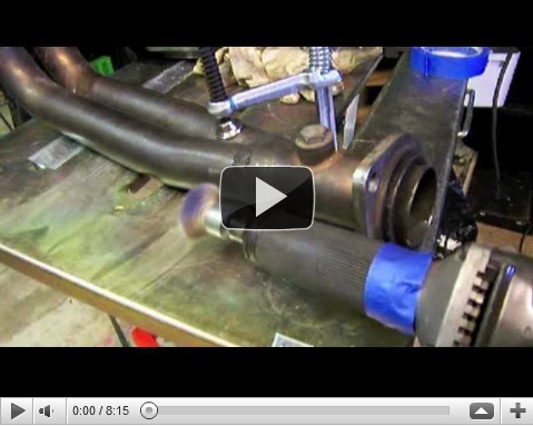

321 stainless steel is widely for automotive,  motorsports,  and aircraft exhaust components.
Examples where 321 stainless steel is used:
ss exhaust repair yt frame
