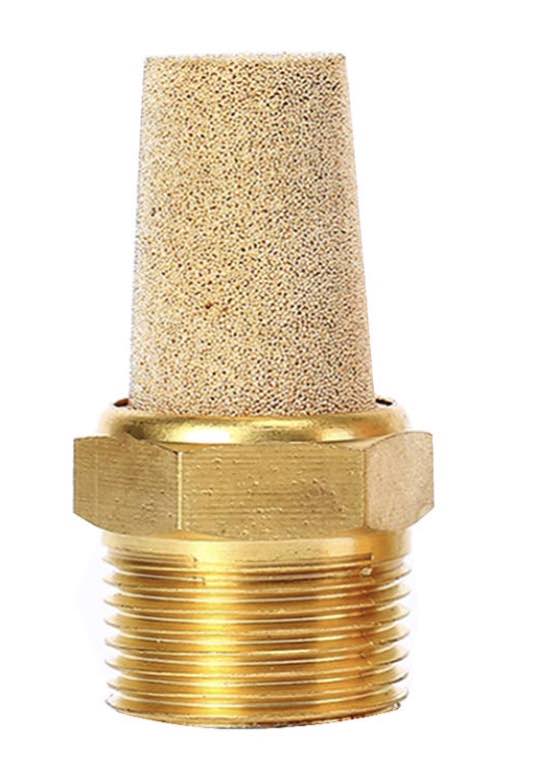

  • a diffuser on the end of the purge hose like a sintered bronze air grinder muffler can help greatly
sintered-bronze-diffuser
Too much flow can cause turbulence and pull in air. Use just enough to create laminar flow.
