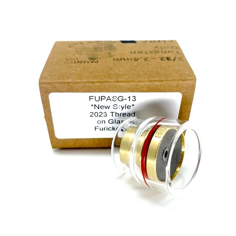

What is the best cup for Titanium?
cippy cup product image
The best tig cup for titanium depends on the scope of the work, whether chill blocks are used, and a few other factors.
In the video on this page, I used a furick sg13 clear cup but there are several other cups that would have worked for this tee joint weld.
The furick BBW for example would be a great choice and there is also a unbreakable version called a "cippy BBW"
The fixture used is aluminum with copper inserts so removes quite a bit of heat making super large cups unecessary.
However, that brings be to a very important point.
Titanium is expensive. And welding specifications like the D17.1 have limits for discoloration.
So a little extra argon required by a larger cup would be a good spend.
