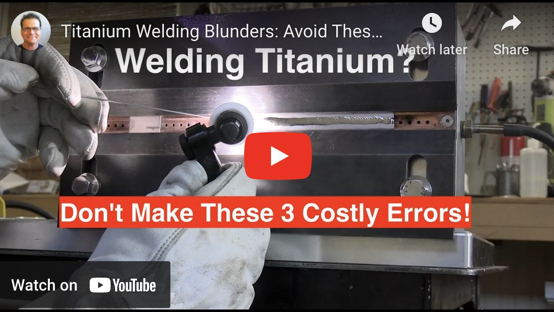

TIG Welding Titanium is not all that difficult to weld.
Unless you make one of these 3 big mistakes.
So what are the 3 biggest mistakes when TIG welding Titanium?
How to Avoid the 3 Biggest Mistakes for tig welding titanium
