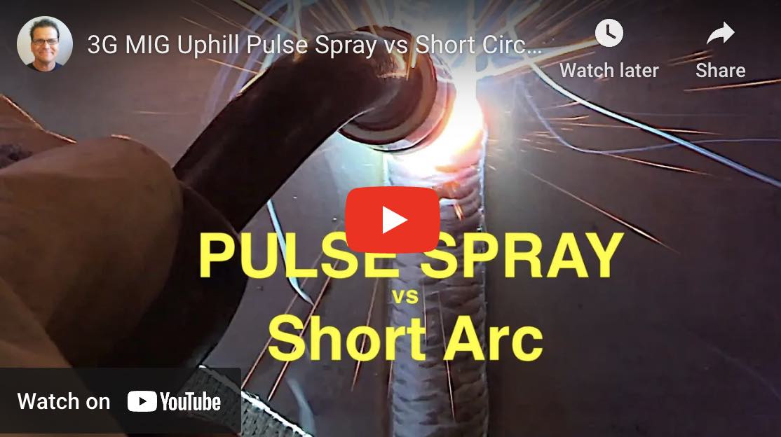

MIG welding - short circuit, Spray transfer, pulse spray, and Mig aluminum with a spool gun
pulse-spray-v-shortarc-thumb
MIG
mig welding excels in production.  It is usually much faster than tig or stick.  But as already mentioned, it is not as versatile as Tig.
Shielding gas is needed for mig welding so for outdoor welding, special wind blocks, curtains, etc might be needed.
MIG welding is a great process if all you do is carbon steel in a shop environment.
There is short circuit mig for light to medium fab work
Spray mig for hot and fast production
And pulse spray mig for pipe shops and other all position welding
Mig welding aluminum is also spray transfer and often requires using a spool gun due to the softness of the aluminum wire and problems pushing it thru a long mig gun cable.
Aluminum MIG can be done using the same mig welding machine as used for carbon steel provided there is adequate amperage.

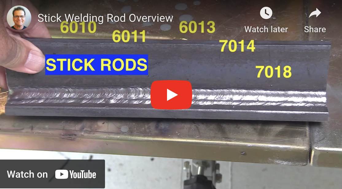

Stick Welding aka Arc Welding = SMAW Shielded Metal Arc Welding
different-types-stick-thumb
STICK
Stick welding is also known as Arc welding and also SMAW shielded metal arc welding.
Stick is the most durable dependable robust process of all in my opinion.
Welding outdoors is not a problem.  Equipment is simple and inexpensive too.
There are different rods for different applications and most small inverter tig welders also can stick weld making it a very portable option for quick small jobs.

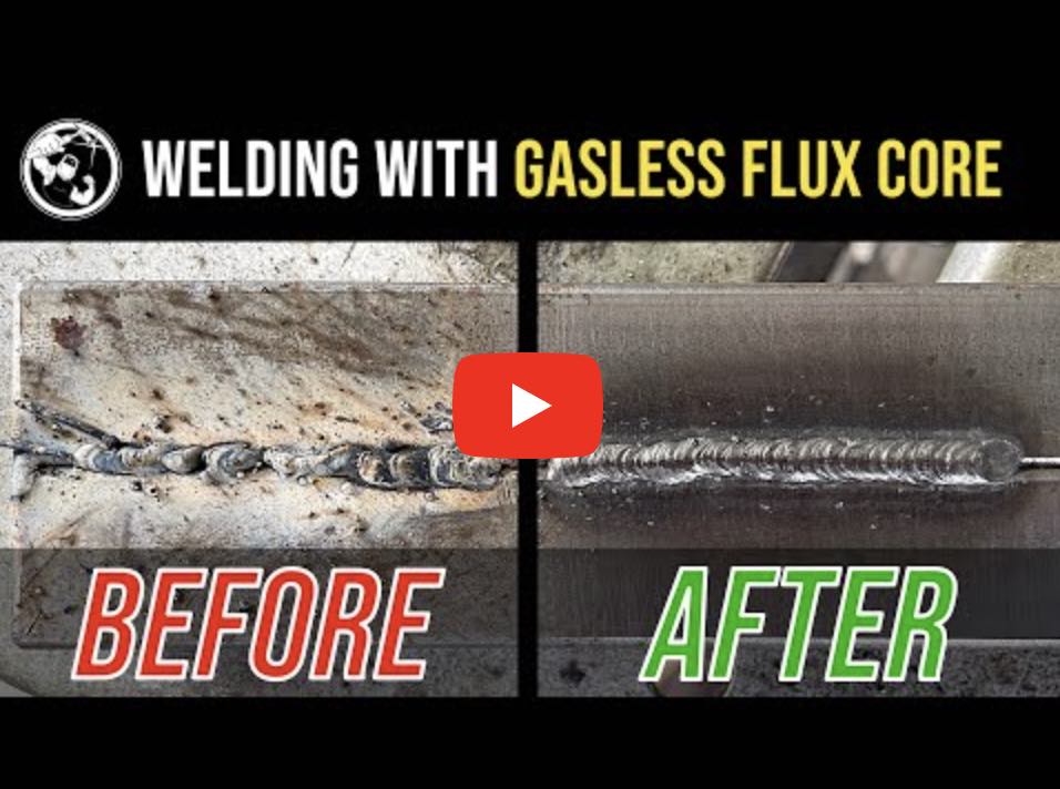

Flux Core Arc Welding - FCAW
flux-core-thumb
FLUX CORE FCAW-s
Self shielded flux core is actually a good way to get into welding.
You can get a small 115volt mig welder at a yard sale, off craigslist or Facebook marketplace that can do a pretty good job on light duty welding or light fabrication.
Self shielded flux core is call self shielded because it does not require a cylinder of shielding gas.
The flux is inside the hollow wire and works much like stick welding.
One big mistake hobbyists make with self shielded flux core is using the wrong polarity.  DCEN is almost always what you need for self Shielded flux core and a lot of mig machines are set on DCEP because that is what works with bare wire mig.
It pays to check polarity whenever you weld with a mig welder. Whether you are using bare wire or flux core.
