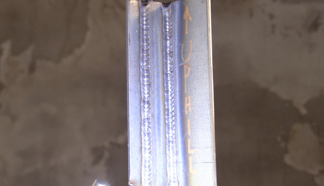

High Inductance and low wire speed
The most practical application i have found for Inductance settings is for vertical welds where you want to reduce wire speed and still maintain a smooth and spatter free weld.
I set up a lap and tee joint on 11 ga steel and welded vertical uphill using an inductance setting of 100% using the Esab Rebel 205.
Using .030" er70s6 wire
19.5 volts
190 inches per minute
I would not normally use such a low wire speed with 19.5 volts and .030" wire but I wanted to show what a difference a high inductance setting makes with super low wire speeds.
Factory recommended settings for 11 ga steel on the Rebel 205 for a flat or horizontal fillet weld using .030" wire are 19.5 volts and 300 inches per minute.
I reduced the wire speed all the way down to 190 for vertical uphill welding and set the inductance to 100% and it worked great
