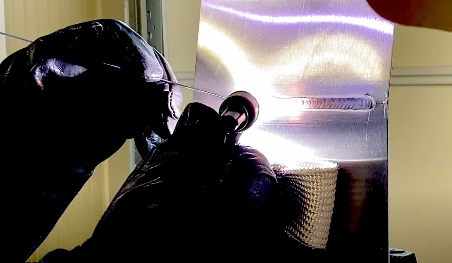

A full or complete penetration weld can be a really thick weld that has been beveled and then penetrated fully by being filled with multiple weld passes, or it could be a sheet metal joint that is .020" thick and is penetrated without any need for a v groove bevel.
The weld symbols vary according to the type of joint.
Here is an example: let's use the example of a .120" butt joint. This could be a full penetration weld without any bevel. The weld symbol for a full penetration weld could look something like this.
full penetration weld symbol
In this example a 1/8" gap is called for.
It is full penetration because no depth of penetration is called for. That’s the rule. If no depth of penetration is called out, it is assumed that it is to be a full penetration weld.
