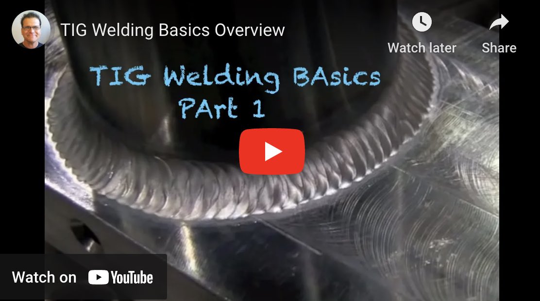

Fundamentals of Gas Tungsten Arc welding (gtaw) commonly called TIG welding
tig-overview-yt-thumb
new-weldmonger-tig-arsenal-kit
new-weldmonger-tig-arsenal-kit-contents
I have created a No BS TIG workbook for you to help you learn to TIG weld...and its free
Download your Free TIG workbook here
no bs tig workbook
Tungsten Inert Gas (TIG) welding, also known as Gas Tungsten Arc Welding (GTAW), is a welding process that uses a non-consumable tungsten electrode to create the weld. Here are the fundamentals of TIG welding:
  1. Power Source: TIG welding requires a suitable power source, typically a direct current (DC) or AC DC TIG welder that does DC as well as alternating current (AC)
  2. Tungsten Electrode: The tungsten electrode is a non-consumable electrode that carries the electric current to the arc. It is made of pure tungsten or a tungsten alloy and has excellent heat resistance. The electrode is sharpened to a point for DC welding and usually slightly rounded for AC welding, and the type of electrode used depends on the material being welded.
  3. Shielding Gas: TIG welding uses an inert shielding gas to protect the weld area from atmospheric contamination. Typically, argon gas is used as it is non-reactive and prevents oxidation of the weld. The gas is directed over the weld area through a cup or nozzle to create a protective gas shield.
  4. Welding Torch: The TIG welding torch holds and controls the tungsten electrode and provides a means to direct the shielding gas to the weld area. It sometimes includes a control switch or amperage control.
  5. Filler Metal: In some cases, TIG welding requires the addition of filler metal to the weld joint. The filler metal is made of a similar or compatible material to the base metal being welded. It is typically manually fed into the weld pool to reinforce and fill the joint.
  6. Clean and Prepped Surfaces: Proper surface preparation is the key in TIG welding. The base metals being joined must be clean and free from contaminants such as dirt, grease, rust, or paint. Typically, the surfaces are cleaned using a wire brush, grinder, or chemical cleaning methods.
  7. Welding Technique: TIG welding requires precise control and skill. The welder holds the torch at the correct angle and distance from the workpiece, maintaining a steady arc length. The filler metal is added to the weld pool as needed to create a strong and consistent weld.
  8. TIG welding is commonly used for welding stainless steel, aluminum, copper, and other non-ferrous metals. It provides precise control, high-quality welds, and excellent aesthetics, making it suitable for applications where strength, appearance, and accuracy are needed.

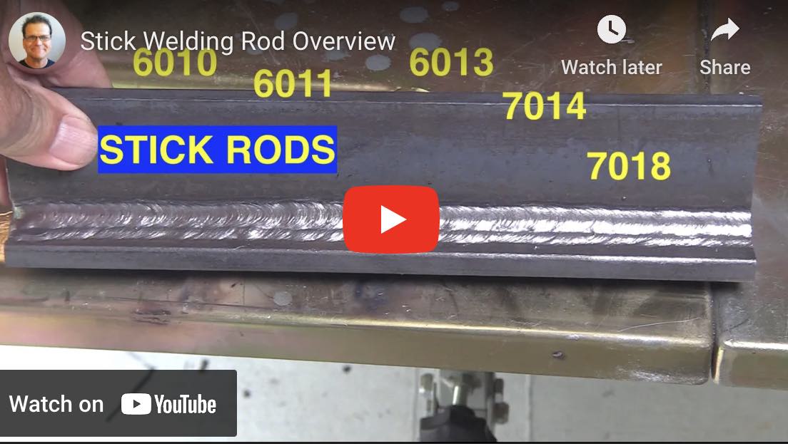

Fundamentals of Shielded Metal Arc Welding
stick-rod-overview-yt-thumb
Shielded Metal Arc Welding (SMAW), also known as stick welding or manual metal arc welding, is a popular welding process that utilizes a consumable electrode coated with a flux to join metal pieces together. The fundamentals of Shielded Metal Arc Welding include the following:
  1. Power Source: SMAW typically requires a direct current (DC) power source, although some applications may use alternating current (AC) as well. The power source provides the necessary electrical energy to create an arc between the electrode and the workpiece.
  2. Electrode: SMAW employs a consumable electrode, which is a metal wire coated with a flux material. The electrode serves as both the filler metal and the electrode that carries the electrical current to create the arc. Various electrode types are available for different applications and metal types.
  3. Flux Coating: The electrode is coated with a flux material, which plays several crucial roles during the welding process. The flux coating acts as a shielding gas, protecting the weld pool and the arc from atmospheric contamination. It also contributes to the formation of slag, which aids in the protection of the weld as it cools. The flux coating may contain additional elements to alter the characteristics of the weld, such as stabilizers, deoxidizers, or alloying agents.
  4. Arc Ignition: To initiate the welding process, the electrode is brought into contact with the workpiece and then quickly withdrawn to establish an arc. The arc creates an intense heat that melts the electrode and the workpiece, forming a weld pool.
  5. Welding Circuit: The welding circuit includes the power source, electrode holder or stinger, and the workpiece. The circuit is completed when the electrode makes contact with the workpiece, allowing the electric current to flow through the circuit and sustain the arc.
  6. Welding Technique: The welder controls the movement of the electrode and the deposition of the filler metal. The electrode is moved along the joint at a controlled speed, and the arc length is maintained within a specific range to ensure stable and consistent welding.
  7. Slag Removal: After each pass or layer of weld metal is deposited, a layer of slag forms on the surface. Once the slag has cooled, it is chipped or brushed away to reveal the underlying weld bead.
  8. Post-Weld Treatment: Depending on the application and requirements, SMAW welds may undergo additional processes after welding, such as grinding, cleaning, or post-weld heat treatment to enhance the strength, integrity, and appearance of the welded joint.
