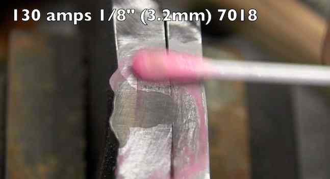

I welded 3 plates in order to get enough video clips and when I finished welding, I thought it would be a good idea to cut the welds that were done at diffrerent amperages to check the penetration as well as weld integrity.
What I saw, was educational.
I know that a 7018 rod is not considered to be a deep penetrating rod.
But I welded some of the root passes at 135 amps.
You would think that since 135 is at the top of the amperage range for 1/8" 7018, that it would have penetrated more.
2g horizontal weld test macros
110 amps barely penetrated into the backing strap
Swab etch using loctite naval jelly ...130 amps penetrated better but I welded too far outside the bevels
penetration is good but  a cluster of porosity showed up.
probably because I left the 7018 rods out overnight.
