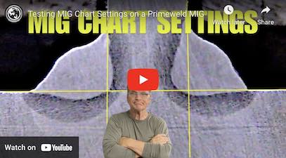

MIG Charts and Settings
mig-chart-settings-thumb-email
You can usually use the settings that are listed on most mig welding machines as a starting point but just remember that those settings are intended for flat and horizontal fillet welds and tend to be a bit high.
For vertical uphill, use lower settings.
Here is a much simpler chart if you are using C25 gas
