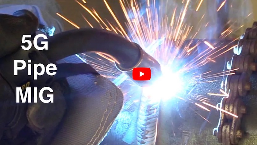

Mig welding a 5G pipe downhill open root...Uphill fill and cap
resized small thumb 5g mig pipe
Some procedures allow for a downhill root for open root pipe or plate.
With a gap, a downhill root works
Downhill short circuit mig welding on anything thicker than 1/8" can easily result in lack of fusion.
With short circuit mig, open roots work very well with either downhill or uphill mig provided correct techniques and settings are used.
Pipe shops often use procedures with downhill root and then switch to uphill fill and cap.
