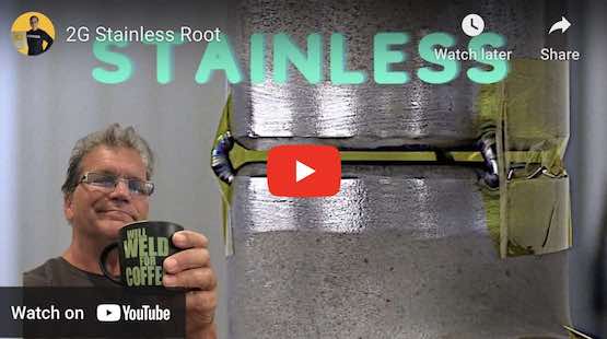

TIG Welding Stainless Steel pipe Root pass technique
stainless-root-thumb-email
This short video shows bridge tacks vs penetrated tacks, root pass technique and all settings used
