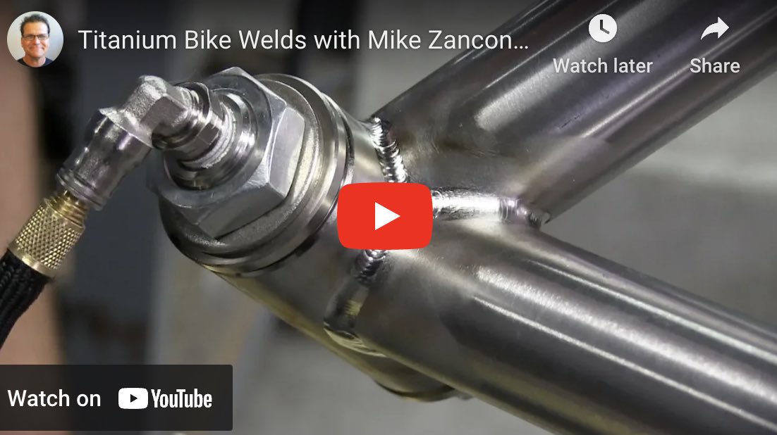

Mike Zanconato Shows us how to tig weld titanium bike frames
titanium bike welds thumb zank
Mike Zanconato shares purging tips, along with tips for pulse settings and more on titanium bike frames
