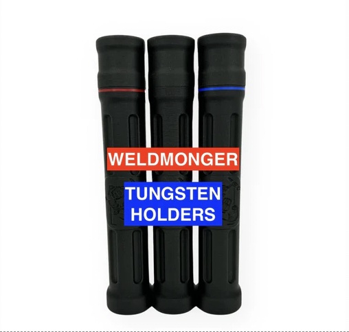

We have tungsten Holders with Color coded bands
at weldmonger.com
weldmonger-tungsten-holders
We put together this tungsten bundle because 3/32" is the most versatile and most commonly used tungsten but you still need a few 1/16" and 1/8"..
you know what I mean???
2% lanthanated bundle with 3 packs

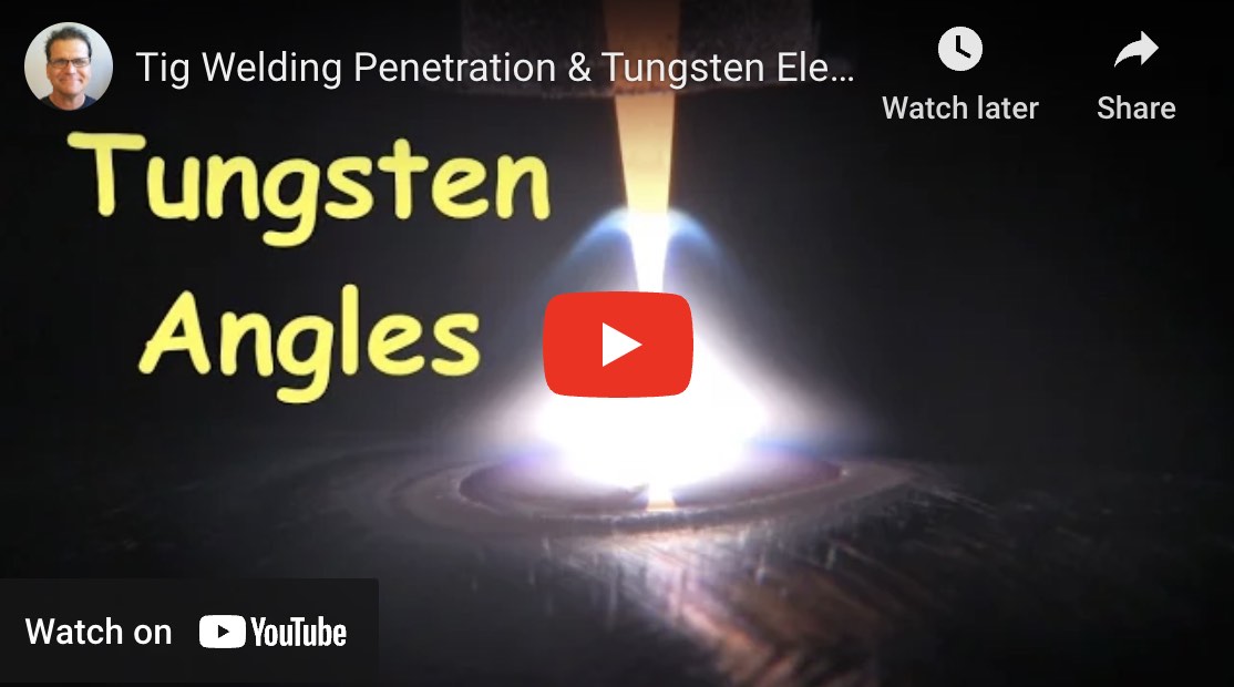

tungsten-angles-thumb
If you have every looked for a chart on the amperage ranges for different diameter tungsten electrodes, you might be as shocked as I was to see the maximum amperage for 1/16" tungsten at 150 amps.
The chart below lists a much more reasonable amperage range.

The tip geometry plays a role in how the tungsten reacts to the amperage. Pointed tips make for better arc starts, while balled tips distribute the arc cone more broadly. Make sure your tungsten type is compatible with the amps you plan to run—thoriated and lanthanated types handle higher amps better, while pure tungsten should be kept on the lower end.
If your electrode tip begins to quiver or deform during welding, that’s a  sign you’re exceeding its optimal amperage range.
