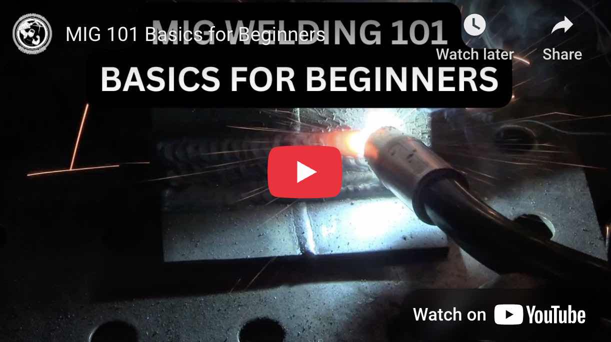

MIG Welding 101 - The Basics for Beginners
mig-welding-101-thumb
It take more to know how to use MIG welder than a a few words...
  So here is a video on MIG welding basics that should help
along with a few other videos on other topics like how to set wire speed and some tips and techniques to get you going.
good luck welder!

  • This Video on Mig Welding Basics shows how to set up a mig welder along with arc shots of what incorrect settings look like
    Mig Welding Basics
