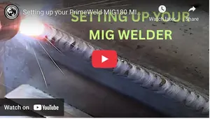

  • This Video on Mig Welding Basics shows how to set up a mig welder along with arc shots of what incorrect settings look like
    Mig Welding Basics
