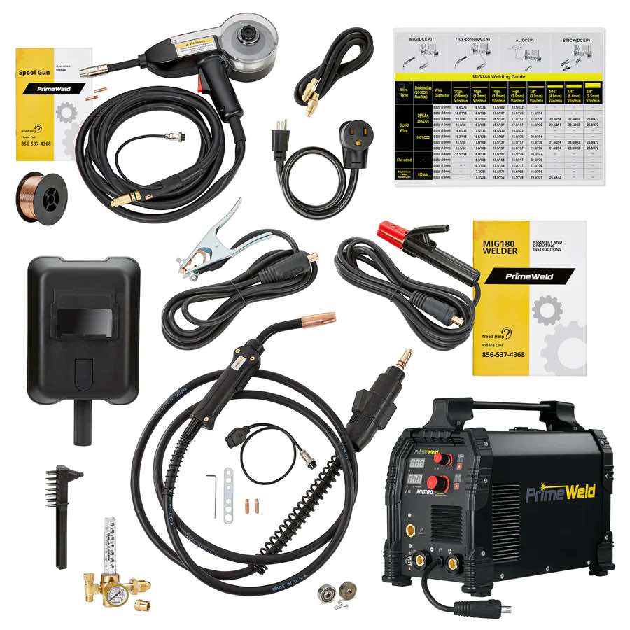

This affordable MIG welder is listed on my store at weldmonger.com
primeweld mig180
primeweld mig 180 stuff
