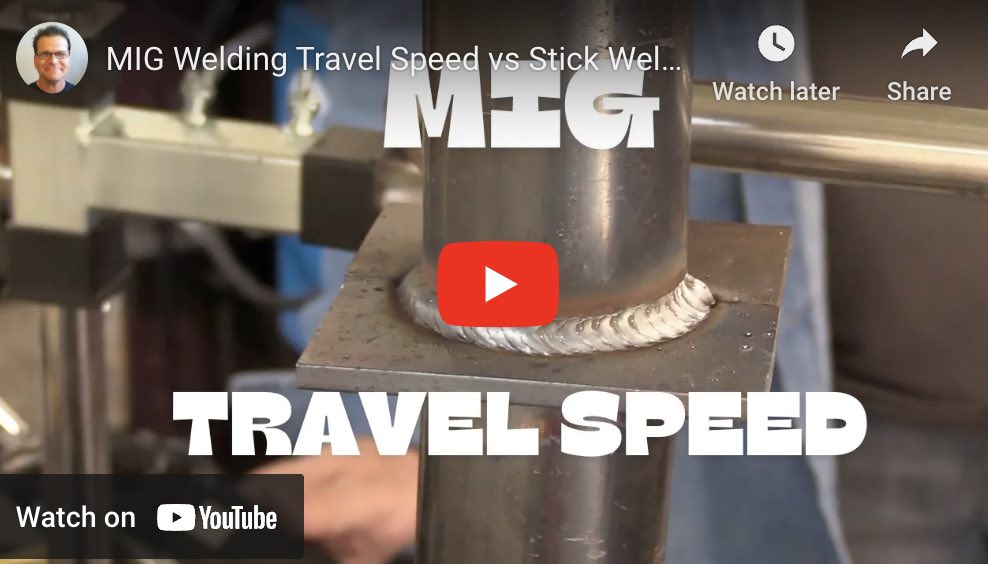

MIG welding Travel Speed compared to
Stick Welding
mig-travel-speed-thumb-wttpage
Wire fed welding processes like short circuit mig, spray mig, and dual shield flux core have very wide ranges of travel speeds.
Stick welding, while a very good welding process, has a much narrower range of travel speed.
Stick welding excels outdoors, for pipe welding, and one off welds or repairs.
But for production, wire fed processes can make you a lot more money.
Especially bare wire where this is no slag to chip and almost no cleanup.
