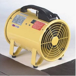

Another thing...i went to a lot of effort to make the slats removable by using a lot of pieces of 3/8" round stock tacked on each side of each slat. . but the truth is , it would be easy enough to tack them in and just cut them out when its time to replace....and also, there are times when you might want to use a clamp under a slat that is welded in to hold something in place. I wont be able to do that with mine since they pop in and out easily. and Finally I know not everyone is as lucky as me to have a Miller Fume extractor....so there is another option. Northern tool has a neat little utility blower that moves over 1500cfm.
utility blower

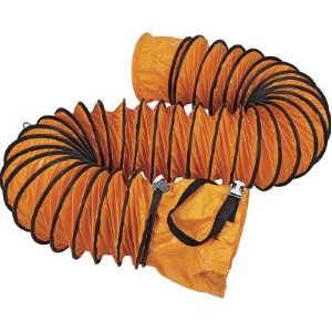

someone could easily make the air box to accept this little blower along with flex hose like this...
